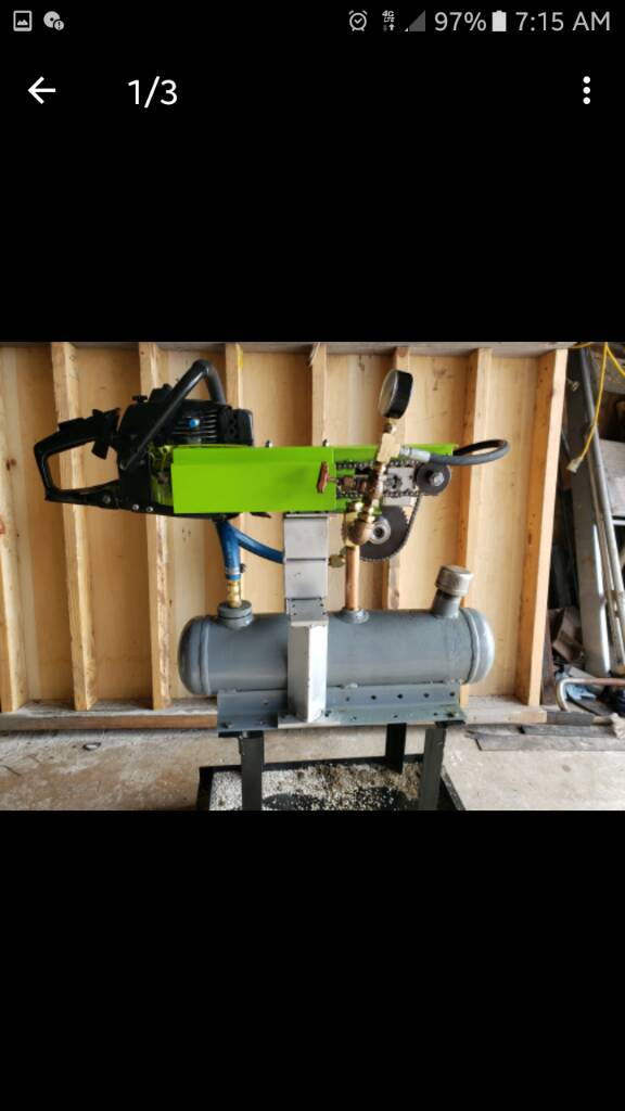

How about this, I think it's 108cc, a guy I know, modded a 3400. He posted it on YouTube also.
Steve on Tapatalk
Maybe I should have changed "ever" to "that often". All I was saying is the frequency of posts regarding mods of Poulan saws is not near the other brands.... It's nice to see Poulans being kept alive.

Well so far the test cylinder my friend is using is holding up real well. He has his own dyno to run it on also. So far so good.
