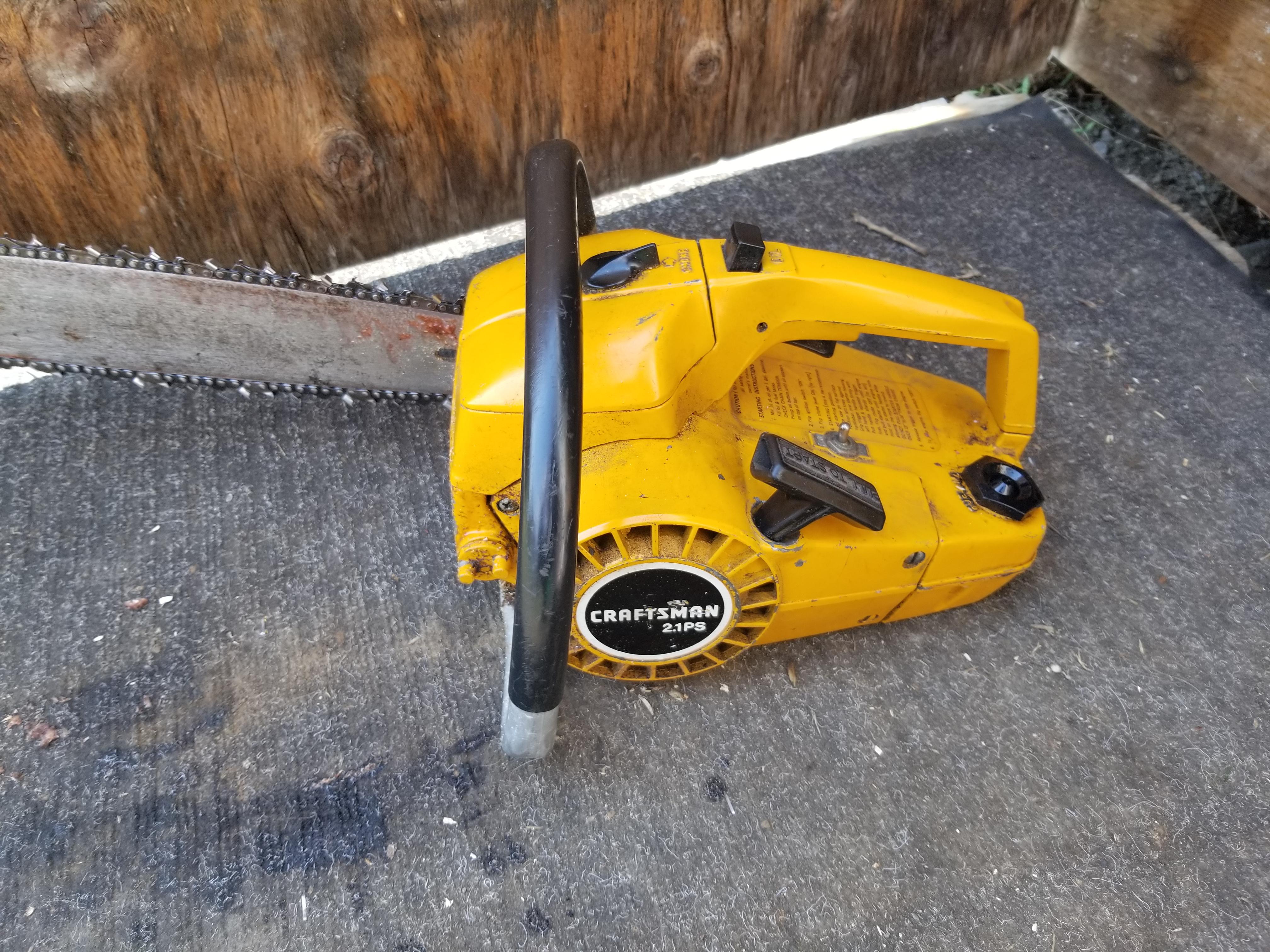

I want to convert this to normal style chain and also wanted to switch over to 3/8 LP.
Does anyone know a part number for a drum that will fit. Or a saw modle that takes the same drum.
Thanks
Poulan PN 530048024
Oregon 28006
They are for 3/8 LP.
Thanks
If I'm not mistaken that's an early variation of a Poulan S25 being the power sharp version and in 2.1 cubic inches not the 2.3 model .They were pretty good saws .Based on that I would assume the drum from an S25DA might work .Those BTW originally used 1/4" chain later 3/8" low profile chain .
