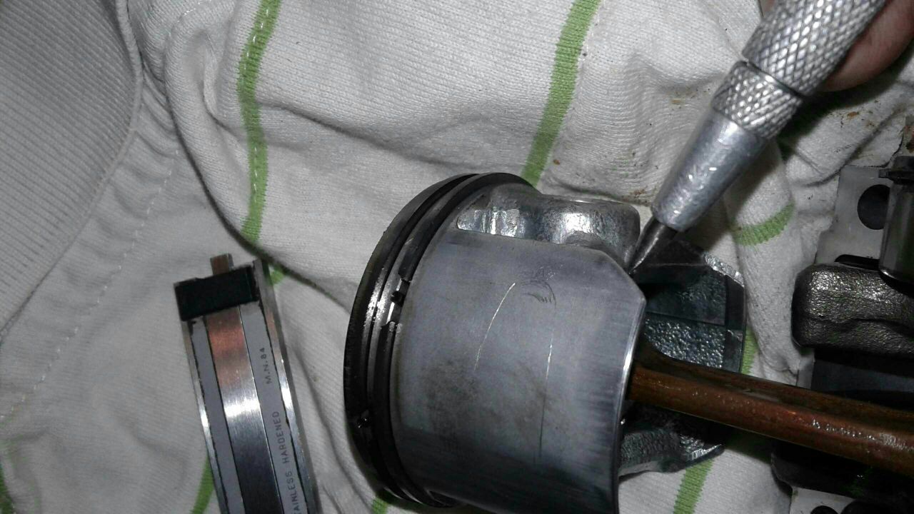

The spot where scribe is pointing. Is that what you mean may caise a hamg up.
Yes. If the port is wider than the bottom of the skirt, it could drop in. It wouldn't have any support
So id be best to not widen the intake side?
Sorry for the dumb question. I just dont wanna ruin anything.

This bottom piont (scribe is pointing at) is exacrly in line with edge of port.

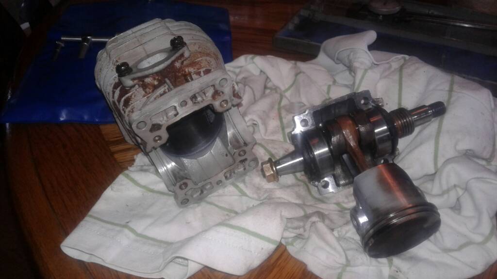

Heres the clam split. I was wondering what echo uses for gasket glue. This is how it looked when i pulled apart. Dont look like much if any.
Wow...I see the difference between my 350 and a true clam now. Thanks for the pic!
