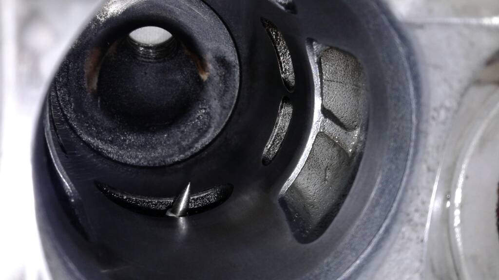

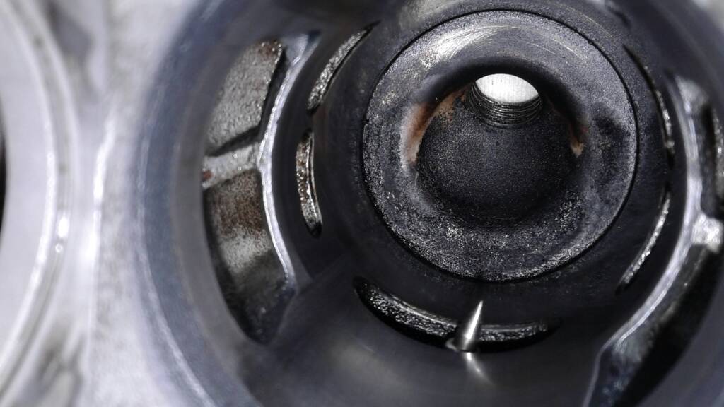

Heres the numbers i figured.
Do these numbers seem about write for the width i can take ports too?

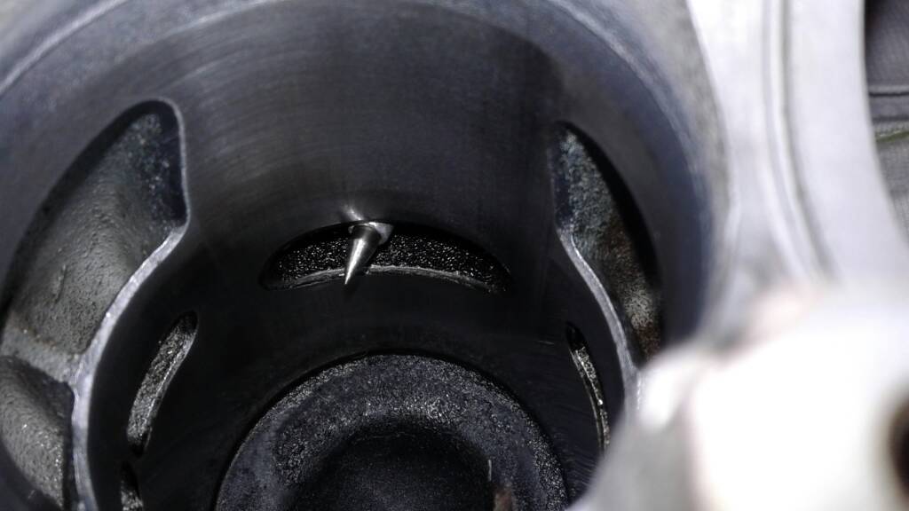

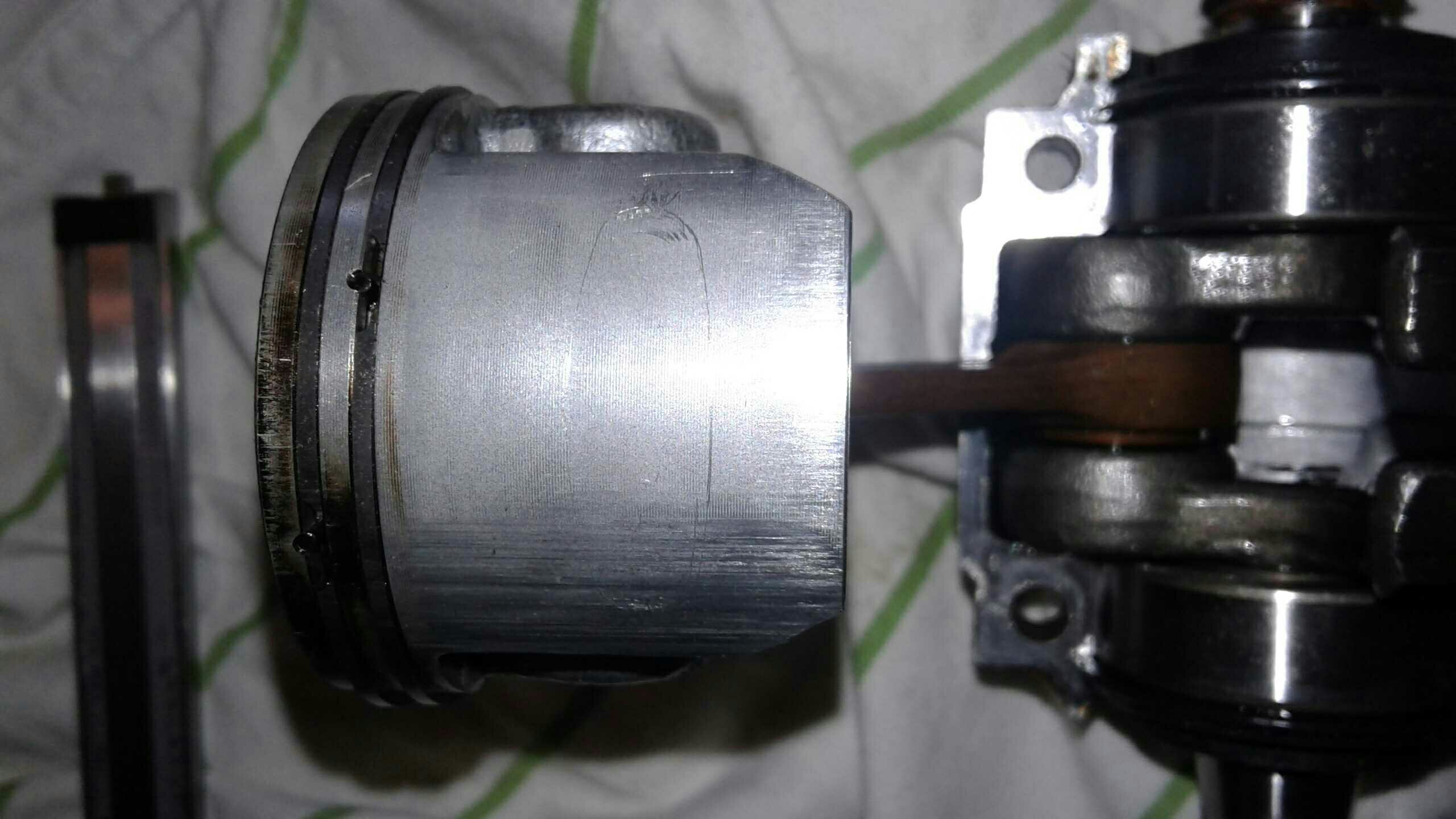

Check ring ends and skirt width.
From pencil mark to edge is 0.100.
I got to double check but i think min is 0.050.
If so i should be ok.
Now ring ends are both on intake side.
How do you determine if ring pins are too close to ports.
And if it matters at BDC the rings do not show at top of intake.
Then it won't matter, just keep your .050 from skirts

Norwich, CT
With that skirt coming in like that it might change things though. You don't want to catch the bottom of the piston in the port
