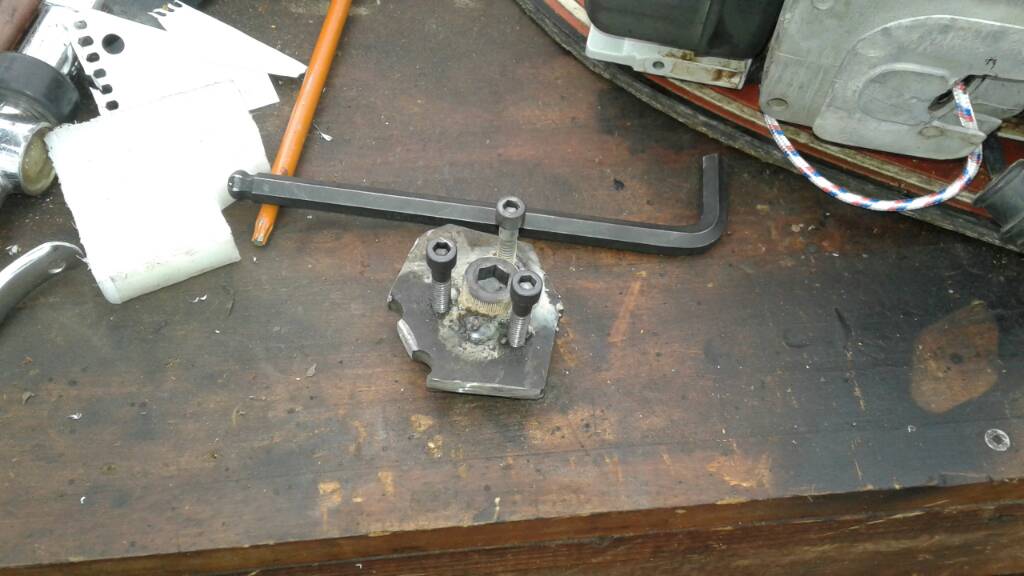

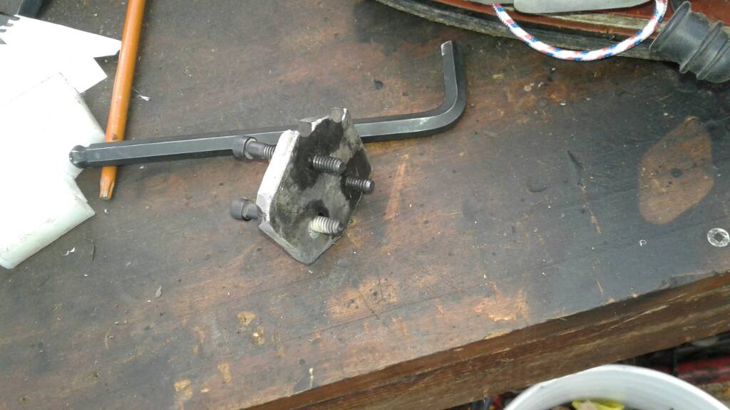

I started tearing the echo apart.
First snag was getting the xlutch off.
This tools not pretty but it worked.
The exhaust is 105
Intake is 73.
Now heres my stupid question. When measuering the intake it when the piston skirt clears the bottom of the intake port?
If so i measured it propper.
