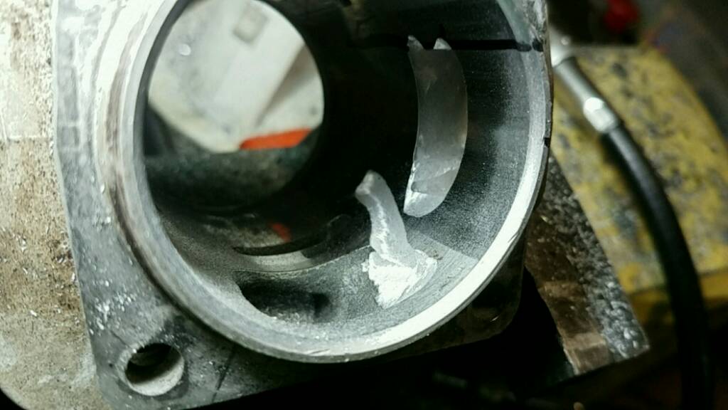

Pics of my oh64 earlier in this post
I know how mains opening a few degress ahead on the quads respond soooo....Anyone ever done exhaust side fingers? Me and a couple guys have talked about em but...just pokin for info.
How's that being fed?
I guess it collects fuel from the intake,those fingers in that configuration will give an open port cylinder around 700 rpm,if you connect them to the main transfers you gain another 700.How's that being fed?
Most everything I do with transfers is try and force the fresh charge to the intake side of the cylinder so a exhaust side finger could be the ticket but it might be more than the rings can bare on that side with the big exhaust port.I know how mains opening a few degress ahead on the quads respond soooo....
Opening the fingers after now?
10 minutes?
