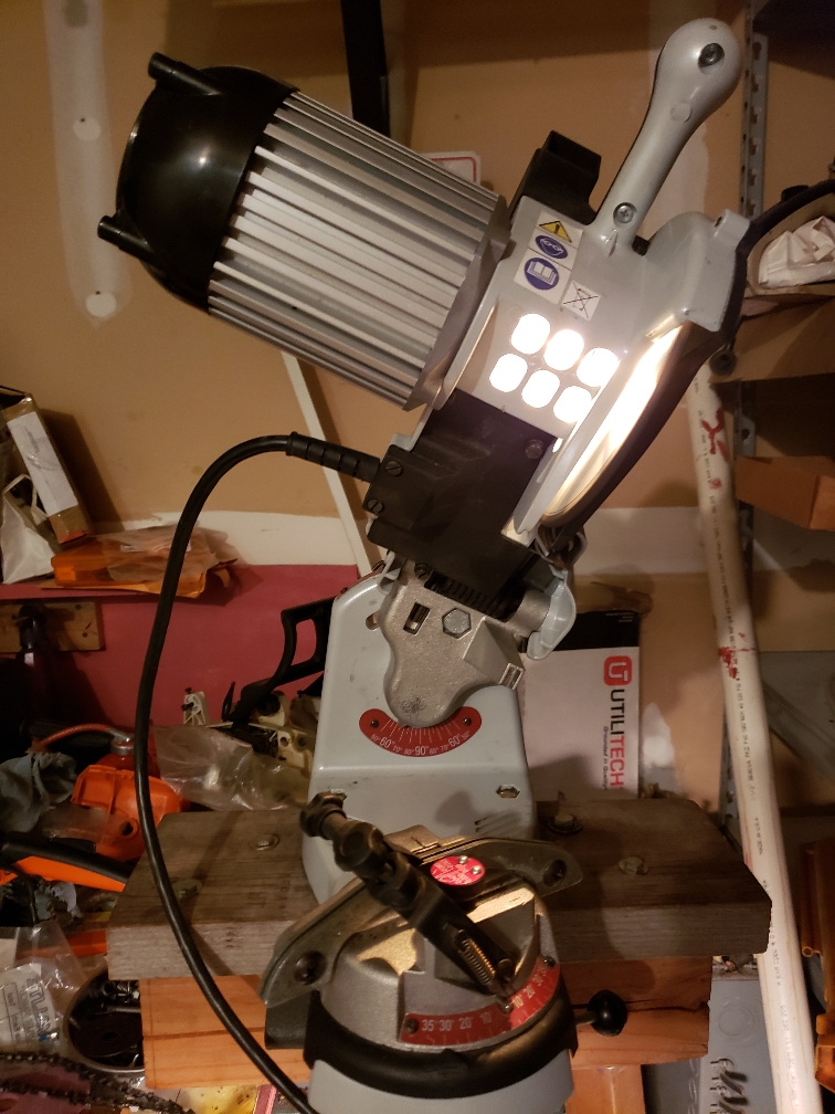

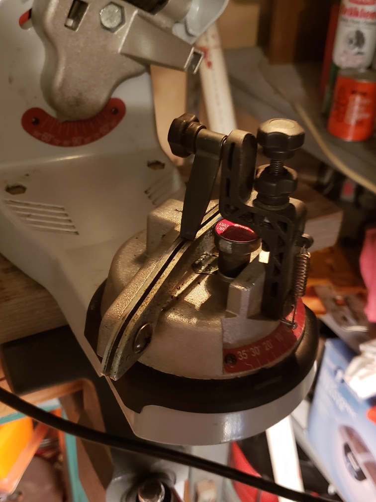

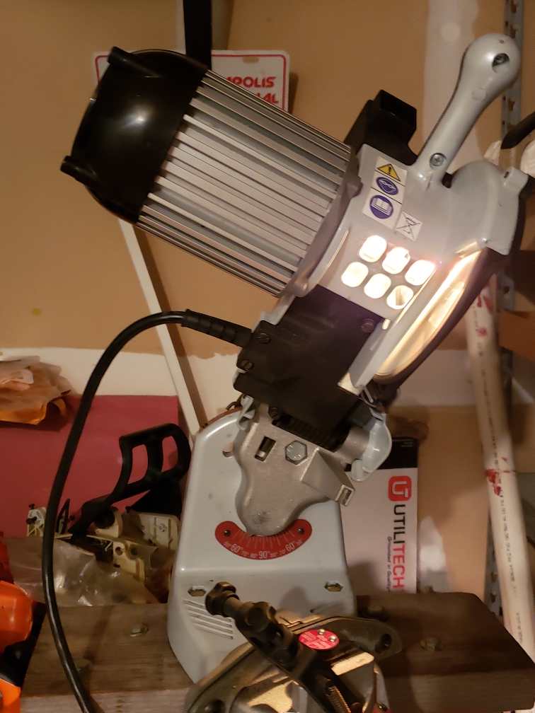

I now use the Maxx grinder bought from Bailey's. Head swivels both left and right and also auto clamps. Really like this setup.
Sent from my SM-G965U using Tapatalk
Some pics

You rotate head, flip chain, flip the grinding angle and flip to tooth stop. When I'm doing more than a few, I'll grind all right or left cutters on all chains then flip and do other side.
I rarely file in the field. Change chains and then sharpen all after dark.
