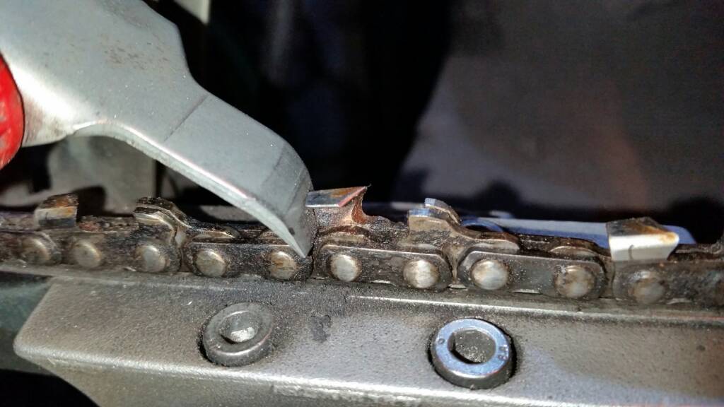

Here is a pic of RM 3/8 safety chain I "touched up" with the USG, I used the stone wheel also.....this chain has a few cuts on it....I made a few test cuts in oak and walnut, it cuts and self-feeds great!!!
RM 3/8 safety chain....

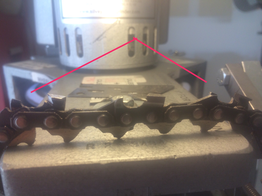

Some folks just don't know what's going on. Here's a pic of before and after on a chain I was asked to sharpen.
The guy admitted he tried to sharpen it and wasn't very happy with the way it cut. There are multiple things I see wrong. It looks like he used the wrong size wheel for the chain, he cut way too deep, the rakers are too short and he may have used a flat file to taper the top plate down...not sure why. Anyway, it should cut much better now.
As a side note, does anyone charge more for the first time they sharpen a chain, and give a repeat customer price reduction? I find it takes much more time to get the chain to my angles and cleaned up. I can imagine it would be much quicker if I were to get them back the next time.

I've seen quite a few DIY'ers try to compensate for a badly dulled chain by taking the rakes way down. Seems to be a common mistake. Sometimes they have just taken out too far. This was a 36 inch chain that probably cost The guy 40 to 50 bucks. Totally ruined. He took off the rakes completely willy-nilly. Had to tell him that even though the chain is now sharp it would still be dangerous to use. In retrospect I should not have even sharpened it for him and told him he would have to buy new one.

To make things worse, it looks like he only did one side.

It looks that way in this pic, but it was hit and miss on both sides of the chain all over.
#Can't fix stupid.....can't even sharpen it! [emoji23]
