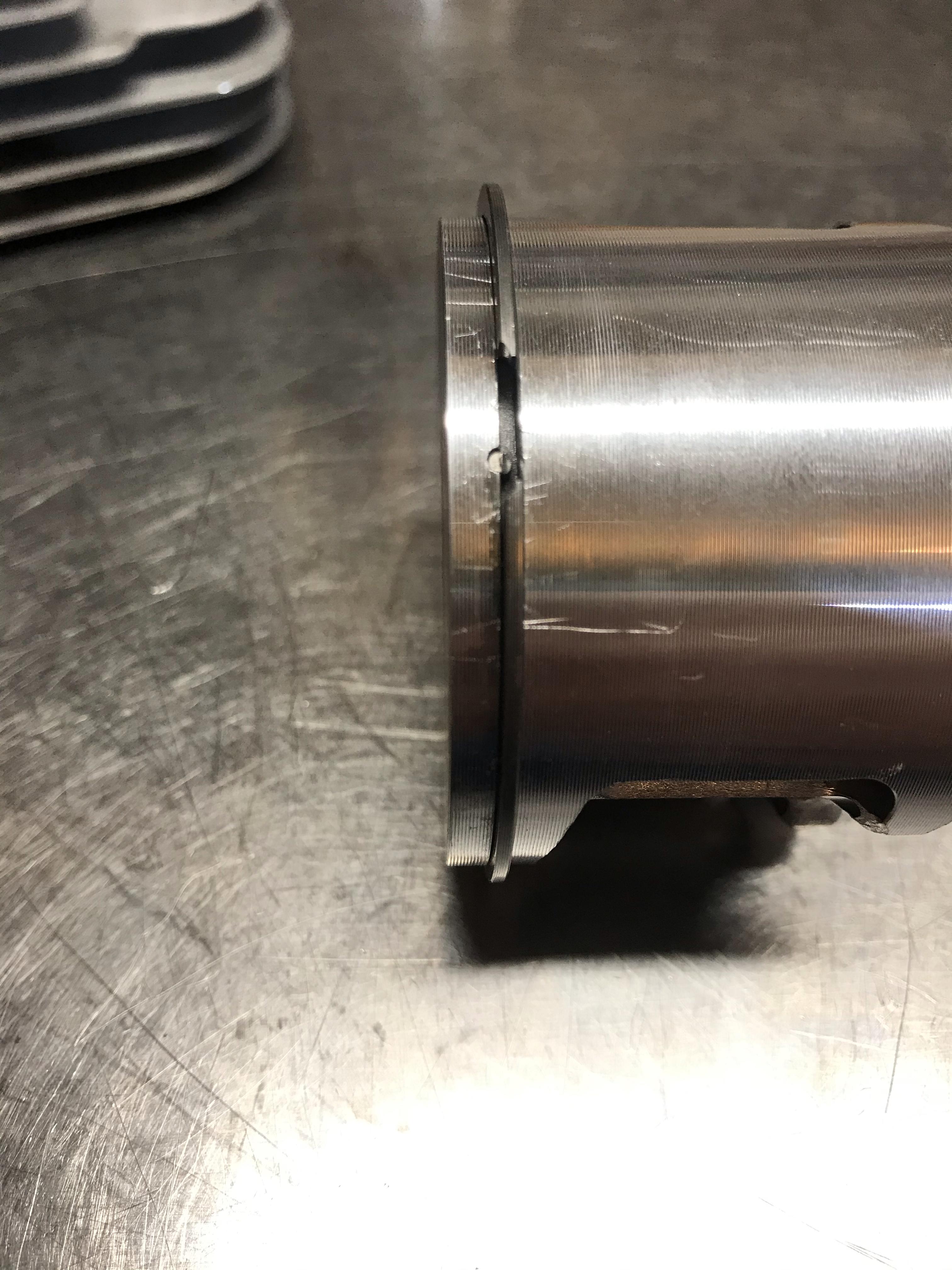

Has anyone had any issues with these pistons? I ran into a couple with the ring land and pin.
The ring land was tight directly above the skirt edge of each window. I had to carefully scrape the bottom edge of the ring land to the correct size.
Next, when I went to assemble it there was excessive ring drag. Turns out the monkey who put the ring pin in let his drift wander and knarfed the ring land and peened the pin down. The damage is holding the ring open slightly.

I heard of this ring groove tightness before with other wiseco pistons from Dominant saw, and their dirt bike pistons. It is an easy fix with a ignition points file, as its thin enough to fit into 1mm ring groove and remove a very small amount of material

I haven't put mine in service yet, but the ring on mine fits well in the land. My also has something funky going on with the ring locating pin and the ring won't set flush around it.

if anyone else has issues PLEASE let me know here in the thread so I can just direct the Wiseco rep to one place to see all the carnage
thank you kind fellows and we will get it all straightened out

OK guys we are going to recall these pistons, they just aren't right. Full refund and they are going to try to make a better batch.
Please return the pistons to me, feel free to PM me here for address and postage
