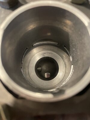

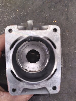

Biggest band/ tightest chamber I've cut yet... 20231125_181646.jpg
I've my work cut out for me but @farminkarman it fell right in at 106/78. I'll raise the uppers and open the lowers. Had to relieve bore extension to clear case and nip the fly side tunnel a smidge. Looks like this will be a decomp saw. 362,take two. There ain't enough meat left for a take three, so here's to hoping 🤣

Biggest band/ tightest chamber I've cut yet... View attachment 398311
This is what my last 362 looked like after cutting 0.045” from the squish band:
