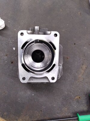

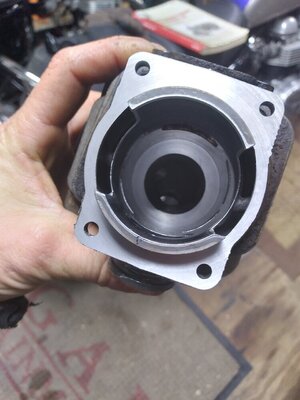

Both band and base finished with a spring pass, rotating compound dial by hand20231021_112906.jpg

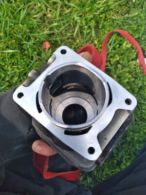

I don’t use the tailstock or a mandrel to center or dial in the jug in the 4 jaw so not certain. I use a long reach dial indicator on the x and y axis inside the jug
I just went for it on the 361. Used gasket and eyeballed center to mark holes on plate. Blasted em and chucked up on lathe and was centered and cutting in a half hour. I could complicate a fart. I've been wasting hours trying to make the plates perfect. 20231112_170520.jpg

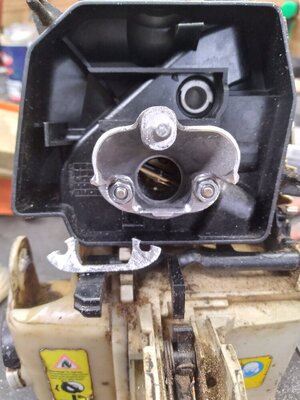

Back to carb stuff. 461 airhorn saves the day again. I'm fixing to eliminate that plastic elbow inlet horn abomination these 361's carry all together. 20231112_203733.jpg
Fits with heavy modification. I'm thinking the HD 50a off the 461 lends itself better than a 440 carb, as the throttle cam is on the right side. Talked to @drf256 about it, and Doc pointed out that the impulse nipple would interfere with the throttle linkage. I'd like to try and drill the impulse passage into the 50a's body, then I'd just need to swap plates, and keep the 361 intake boot. Has anyone tried similar?

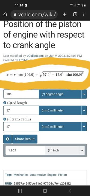

@farminkarman , @huskihl , @Ketchup , @drf256 ,anyone else on here.. My maths has me taking another 42thou off base of this ms362 to bring the exh down to 106*. I took 16thou to go from the stock (no gasket) 100.5*, to 102*. Does a total of 58thou seem to correspond with anyone's else's notes aiming for 106* exh on these saws? Self doubt in my maths has overcome. Interestingly enough, that doesn't land int at 78*. I'd have to take another 57thou to hit that, making for a total removed of 73thou. Seems like alot of base! My goal is to keep uppers nice and tight, so I was hoping to avoid raising exh. I appreciate you fellers. Thanks in advance!

Thanks Kevin. I think my maths is wrong. I'm bad at maths. I have to be careful. I've been using online piston position calculators. I only got to use torque soft once, and it brought me to the 102 point with absolute precision. However, that software apparently no longer exists. So I'm trying this one :
However it works with crank radius rather than stroke, which adds another step of division. I had initially found stroke and rod length using rather jurassic methods. I came up with a 57mm rod and a 34mm stroke.

I currently have 26* of blowdown. I took 16thou off base to get to 102*,but that's minus gasket. One of the reasons I don't want to raise the exh Is free porting. Using the calculator, I can see piston pin position @ 2.007" for 102* exh, and if I were to lower jug to achieve 78* intake. Seeing that crossover concerned me. That's when the bulb went off in my head as I noticed the tab on the skirt, intake side. In my mind it appears to be close to Freeport already.
