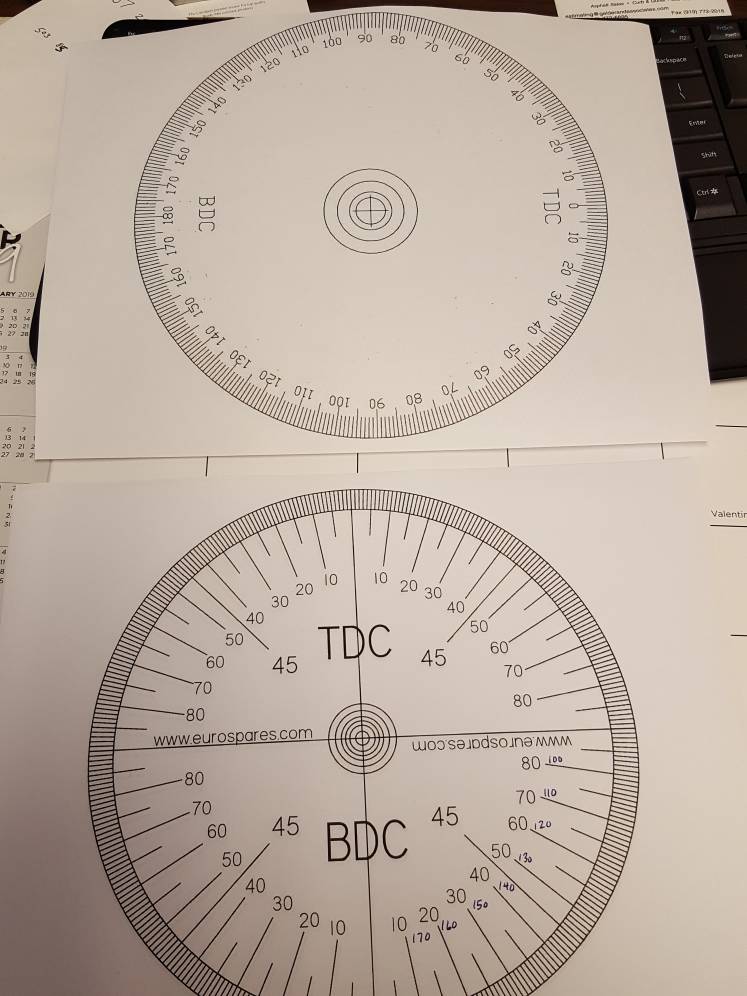

Things are about to get serious... and possibly intelligent?!
mettee
3:08 AM
5872
Apr 10, 2018
1,425
5,405
Arizona
I cut a piece of $7 lexan from HD into a circle and glued the paper wheel to it. Then I used a $20 chuck to mount to the crank. Not sure how you are doing it but thought I would share that.
Circle was cut with a router.
Jimmy in NC
6:08 AM
57
Dec 23, 2015
2,017
8,063
North Carolina
$6 chuck and probably poster board. Real simple.
