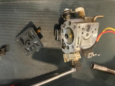

Leave it hooked to the carb and pull vacuum?

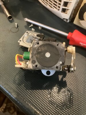

Carb holds vacuum through the fuel line, carb rebuilt, new air filter. Still acts the same, swapped solenoid from green to black to green again, new fuel filter. No change.

I only thought about checking the wires after it was back together. I’m going to see a guy with a pile of parts saws tomorrow and hopefully he has a smashed 462 to grab parts from. He has the 362 stuff I need he thinks but won’t check so it’s an hour long drive that’s a gamble. It almost acts like it’s limited the rpm’s and then flooding itself out.
