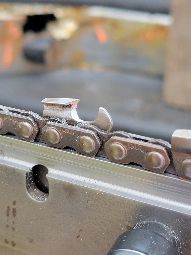

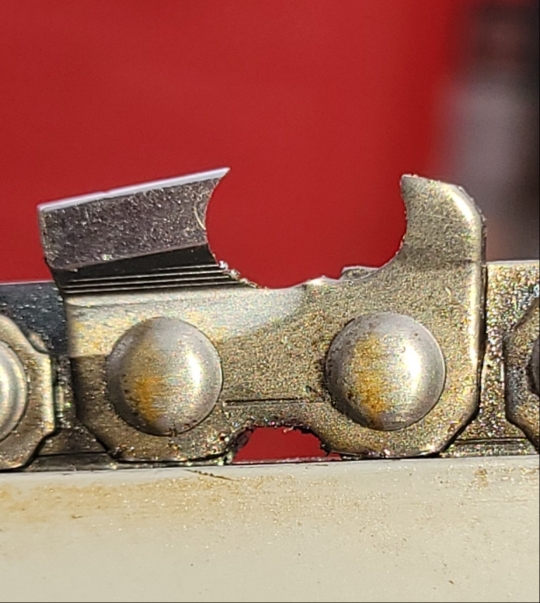

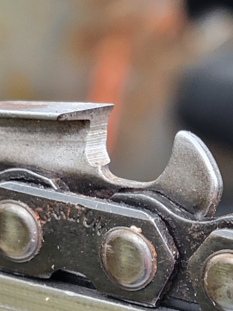

I have a loop of Archer. Off the roll is ugly, but once you touch it up to your liking, it cuts well. Even Carlton box chain is ugly. It needs to be tuned before use.
Archer, Carlton box chain, Carlton after a couple of swipes.
