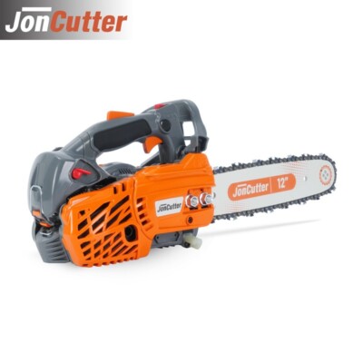

A little closer view of your pics. At least one main difference between the original ECHO and the clone: the bar studs. Two vs one. The copy is not an an exact copy. What else?
Hoping for the best. Real curious about the weight vs the original

Ran half a tank cutting mini cookies. Can't think of a thing to complain about. Well one thing. The full chisel chain that comes
on it is too aggressive for the tiny saw. So i have an echo bar on order from home depot and will put stihl pmm3 chain on it.
I doubt the parts are interchangeable with echo 2511t parts. The saw is identical on appearance and weight to the 2511t from echo.
For $99 delivered i am struggling not get another one.

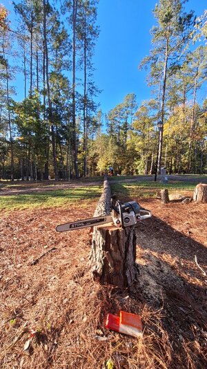

I did get a chance to drop some trees with the " Pro" model G366 from Holzfarma' .
It has an extra port in the muffler and an actual stihl decomp, but basically untouched.
It performs well and pulls a 25" bar with skip pretty good .
