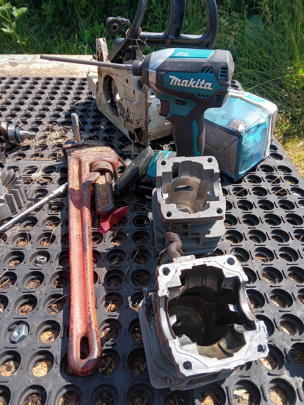

Actually the kit looks very good
I did one of these 9 year's ago for a guy he still runs it no problems
Ft seems to do a better job with open port cylinders.
