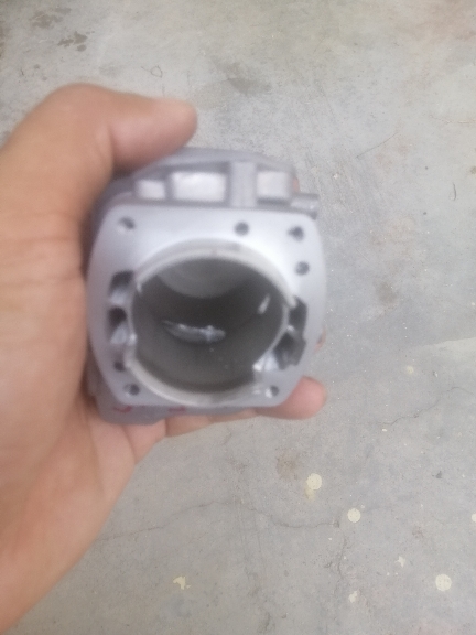

Excuse the low quality pic, but thats the idea

I thought the existing decompression port was good enough. But I can imagine the issue if up in a tree with tons more compression.
Its enough for stock setup
This cylinder got base machined for port work and all the mod so it'll need that groove freeing up for easier starting
Stock squish was 0.04, this landed at 0.017
