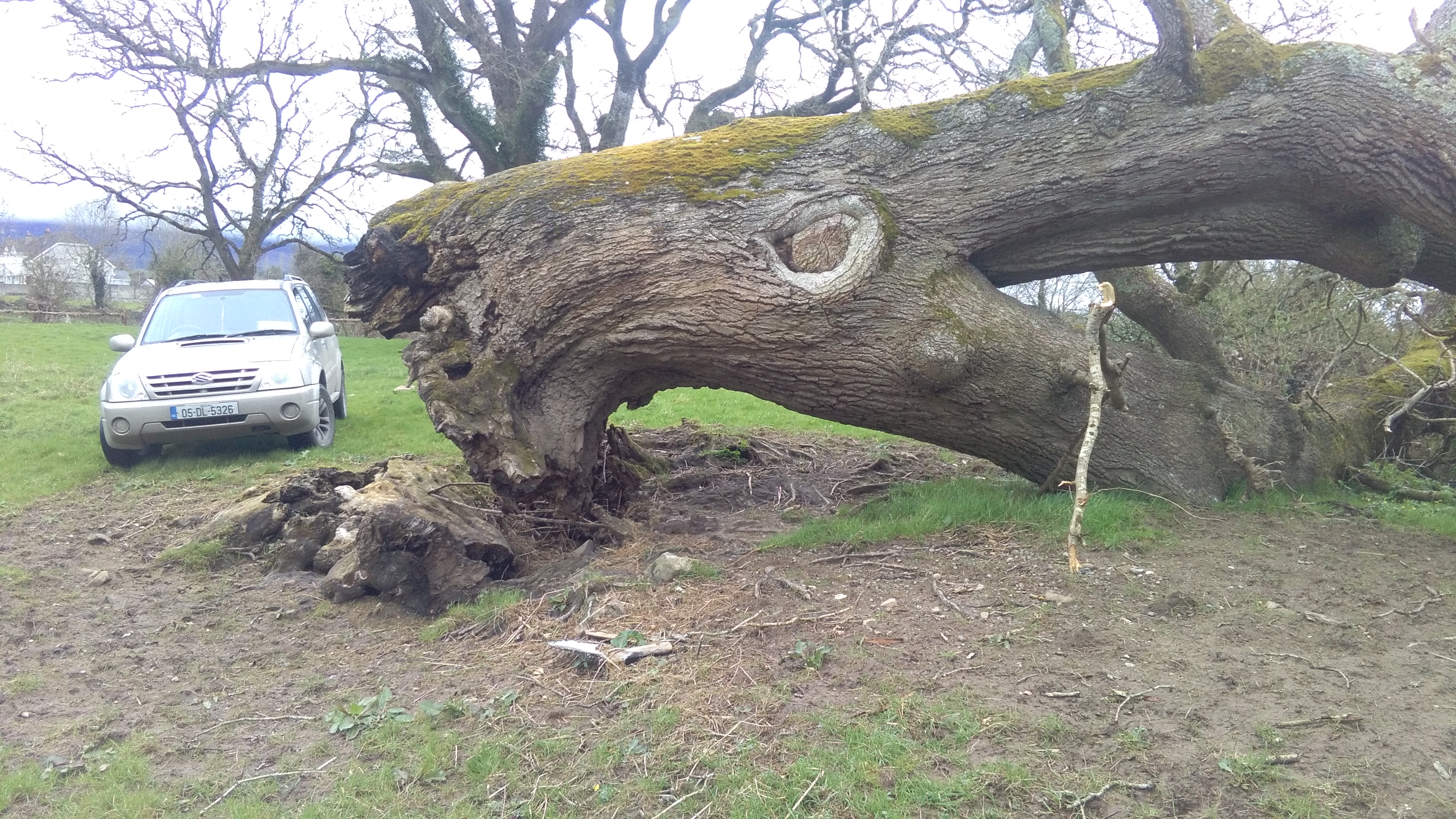

In case y'all missed it when I put it in the ported saw vid thread:
It's had the intake massaged, lower xfers opened a bit, and minor exhaust work, with major muffler work. Nothing too drastic. I mostly wanted it to be a torque monster that was reliable that anyone on the estate could use, assuming they could handle it.

I made a huge mistake. The original manifold/intake gasket tore as I removed it previously. I didn't have one handy and was expecting to replace it before this vid. It makes little difference on the running side of things, but it sets the carb almost 2mm closer to the cylinder without that gasket and will likely eventually start to melt the plastic manifold. This means the silly arm of the 288 throttle 'linkage' won't correctly lever against the rather strong return spring on the NOS tillitson. SO if you lift it, which causes the handle to flex a bit when you have 32 inches of bar on it, the throttle won't activate much of the time. Sorta frustrating. It took a lot of takes before the throttle started to behave which is why ya see me panting at the beginning of the 288 part if you look. I had to restart it half a dozen times as I tried to sort it out. It's something you never would have noticed until you put the bar on. But entirely my fault. I am making a new one from scratch at the moment to sort it out.
In other news - that freaking thing pulls like a freight train. It's a meteor jug and piston. Sort of has a high exhaust, but it was good size, so I only just cleaned it up, added some timing and width to the intake, and removed the lower xfer lips.Didn't mess with the uppers. So it's sort of like it's half ported. I didn't want a high strung machine to leave on an estate where anyone could use it. I just wanted it to kill big oaks without bogging. It pulls great straight from off idle. Loud AF tho. That is it's first cut, too. SHe's not even got a tank through her yet.
In the vid it is running semi chisel vs the full chisel the ported 044 is running. With an 8 pin rim, even with about 2000rpm less in the wood, it is right there with the 044 in this smallish piece of oak. The semi chisel also seems to drag more wood out of the kerf than full chisel when it's fully seasoned. What the vid doesn't convey is the massive difference in how the 288 pulls me in to the wood vs the 044. The 288 just want to pull and pull by comparison.

One of the reasons I ported it conservatively is I wanted it to last - this isn't a toy. This thing has to cut bazillions of board feet, and it has to do it for firewood. That means ringing up huge pieces of oak all day every day for production.
A 288 makes great power with an exhaust mod. It has boatloads of intake and carb, and the air intakes are nonrestrictive even on the low top. When it was a ported 281, no one other than myself could really start it. It was also destroying starters with 210 psi compression. So I added the meteor cylinder with decomp, and left the gasket in. The saw you see in the vid there has a .045 squish and no ignition advance. As it sits now it's 170psi or so. I doubt it needed the porting, but since I had the cylinder in my hand, I had to fiddle with it some or I would have been telling myself 'what if it had 2* more intake instead'. The saw in the vid has 2* more intake, so no need to ask the question. It lives by a river at the bottom of the Comeraghs. So the air is always cool and dense. I find this makes all saws run well. High compression isn't a necessity here. The Echo at the beginning is actually fairly strong for it's displacement. It just had to contend with this thing:
That 288 chewing thru it as though it almost wasn't there actually says a lot. That was the hardest piece of oak I ever cut. It's been sitting at the bottom of the pile for 6 years.
