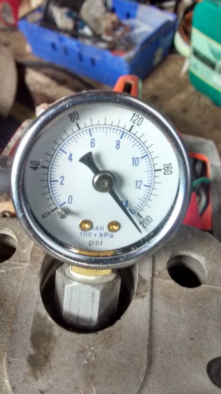

This is on my last 281xp the moment I had her together, before any run time at all. Squish at .031, and I am at maybe 300' altitude near a river, so nice cool and dense air here:
