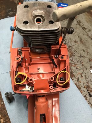

FYI, when I bought my 394 off a guy last night, he told me it was likely the wire that had his Kill switch to permanently ON. He said to just pull out the choke to kill the saw.
I decided to check for shorts in the wire and the blade connector was off the wire inside the shrink tubing.
I soldered in a new connector. Still not killing the saw. I wasn't sure if it was wired right as I got it either, but I think it is right judging by this pic from the first page. I may just need a new switch plus possibly a short in the wire under the pull start. I need to put an ohm meter on these.
huskihl
Muh fingers look really big
8:31 AM
360
23,588
150,818
East Jordan, MI
I’d use the front bolts as they go directly to the case. The rear 2 screw into an insert in the AV springs and may not ground.
