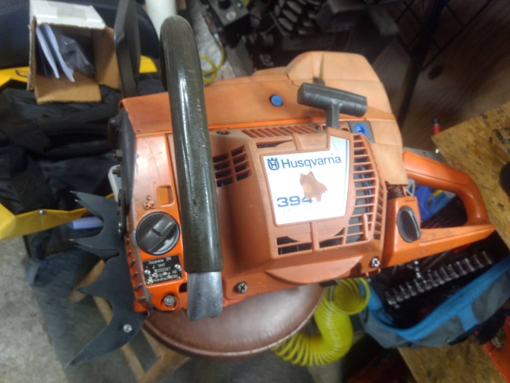

Had that thought but decided to leave it ugly...lol! Battle scars
If it works, don’t fix it, but next time you run across it, it’s an easy fix.;)
You’re gonna laugh. Since I consider myself a hack, I used a hacksaw...lol! Clamped the key in my vice and managed to cut a blade width off which came out to be about .035. A little more than my usuall but you never know anything til you give it a try. Dressed it up after the cut with a small file, didn’t take much.
Its all good as long as it don’t rip the cord outta your hand! Most threads I’ve read say .020”, but that could vary depending on the coil timing.
No stretched fingers yet, I might be in the clear. Nothing ventured nothing gained;). And yes it does depend on the coil you’re dealing with.
