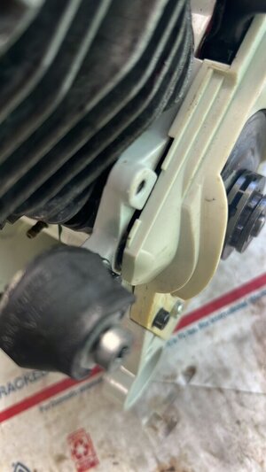

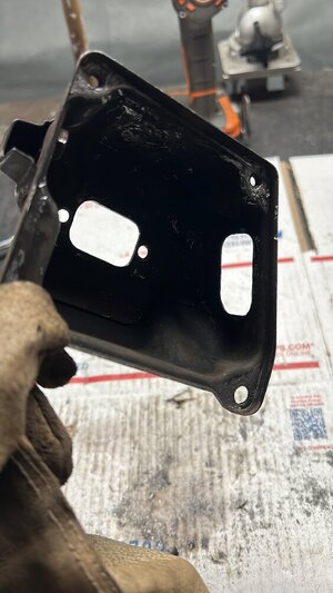

Got a few hours in on the saw. Rough time of the year.
This saw, which was supposed to be all OEM came to me with a load of AM parts. They make the work 6 times as hard to do. I have to search my parts bins for brake parts and redo most of what I did yesterday at this point. Plastic covers I generally use, but usually nothing else. The brake assembly cover is warped, or is cast wrong and hits the spring.
