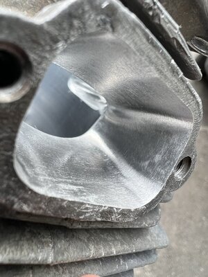

Took 75 off base and 30 from band. Was enough to tuck the bottom ring in the intake roof at BDC.
Im at 100 ex and 84 intake.
Squish came in at 15, so I’ll be sanding 3 more thou out of the band.

Band cleaned up OK. Not the prettiest, but pretty isn’t always fast.
Be a while before it runs, as case halfs out for powder still.
The stock 66 piston just covers the port, but id be a bit nervous running it, though the wings might hold it together. Squish around 19.
