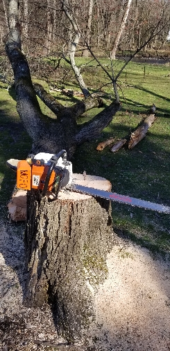

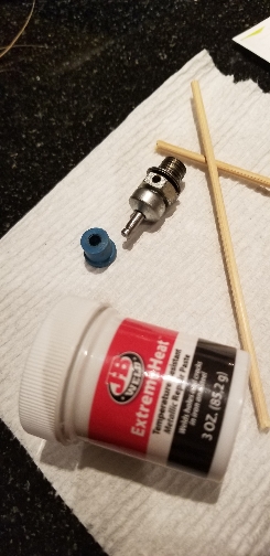

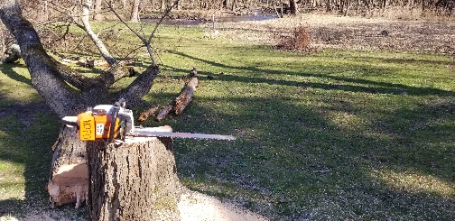

Still no vids...WTF Brendon
Videos coming...
*Propper treatment of the Docs creation!
*2nd adjustment of the lay of the limbs!
*Supplied Husky Blue de-comp rubber glue fails, but all Stihl screws are engaged.
More video to come as the piston ring/s
get/s seated.20200326_151840.jpg20200326_161922.jpg20200326_173109.jpg

Videos coming...
get/s seated.View attachment 232472View attachment 232473View attachment 232474
I wouldn’t run the saw until you fix or replace the decomp. The top mount ones can fall straight into the cylinder and destroy the saw. The side mount won’t fall into the cylinder if they fail. If a saw has a lot of compression or 80-90cc I like a decomp. If they aren’t too high or stock... I just plug them because it idiot proofs the saw. I must have 5-10 failed/leaky decomps in the drawer of my toolbox I threw in there. Got them from various saws in the past year that were here.
Oh yeah buddy!
I saved the Real Deal Stihl Decomp!
I should have known better about Huskies reputation!
Thanks for the tip!
Hands like
a tree surgeon!
