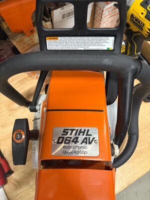

singinwoodwackr

It depends on which chassis you have - if you're building an 064, then you need 9105. If you're building an 066, then you need 9106.
Ok, ancient thread…
But…
Will a 9106 work on an 064 with wrap?

Either a 9106 or a 9104 with a spacer.
The 9105 is the stock brake handle for the straight-across wrap on the 064.
Ok. I have no idea what 1122 wraps I have :p
I was going to send David a handle cuz I thought I had a bunch. Turns out, they are all 1128s 🙄
I need just one for my 064 build and the 9106 is all I could find :p
jmester

I think this washer would work well to close the gap between brake handle and recoil.
3003 655 9200
Washer
worked well to use the 880 brake handle on an 084
