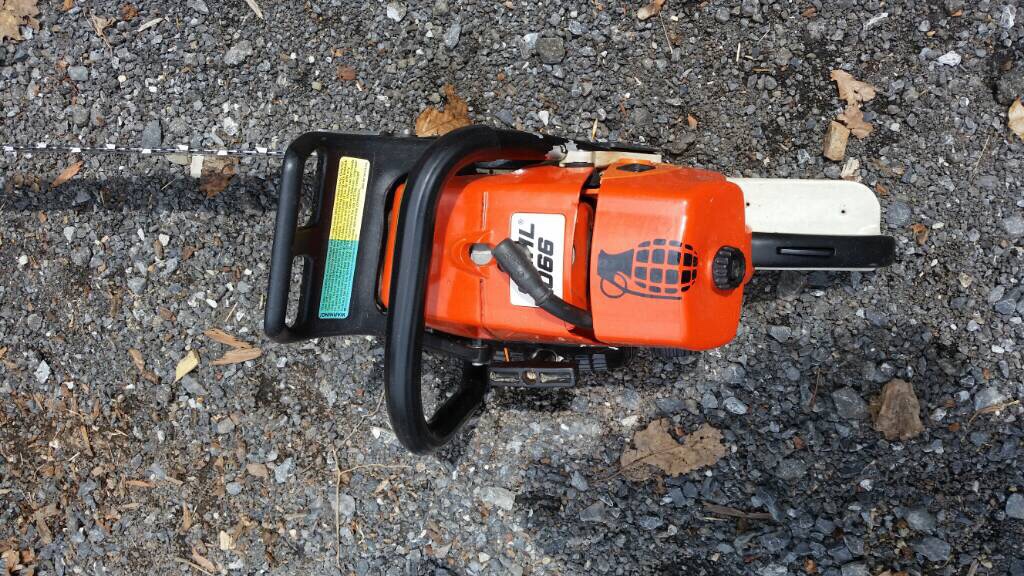

And how hard to change the angle of the spark plug?
When I build mine it's going to be under the plastic and factory looking.
I like everything hid and all the covers on,I don't even like the maxflow filters because the stock cover don't fit.
Thats what I would want, if I were to have one done.
Maybe somethin' like this by @srcarr52 ...
