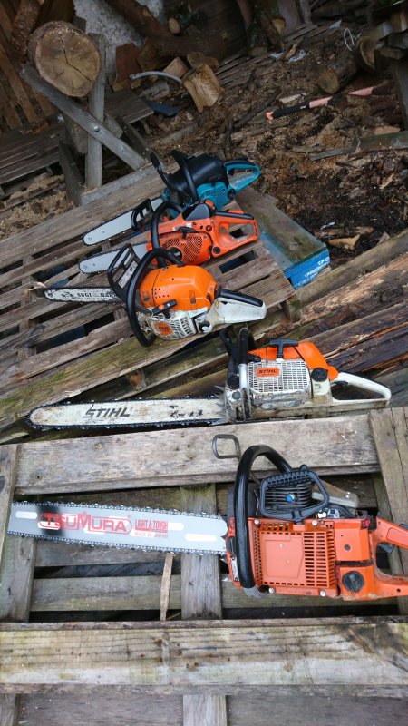

I run a 24. If I need more, I reach for a 288xp.
