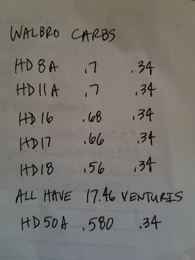

Thanks Jim, I printed that info.
Are they all the same size? Any other differences that you know of?
Also, I think I have HD-16 A, B + C carbs. Any idea what the different letters represent? I assume something must be different.

Some info I got from Walbro regarding main jet sizes.
