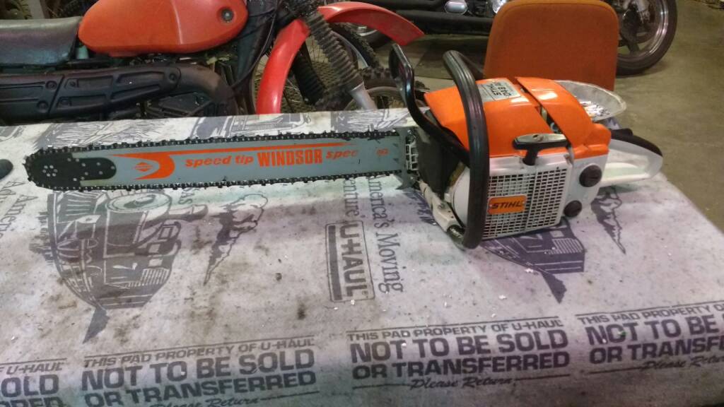

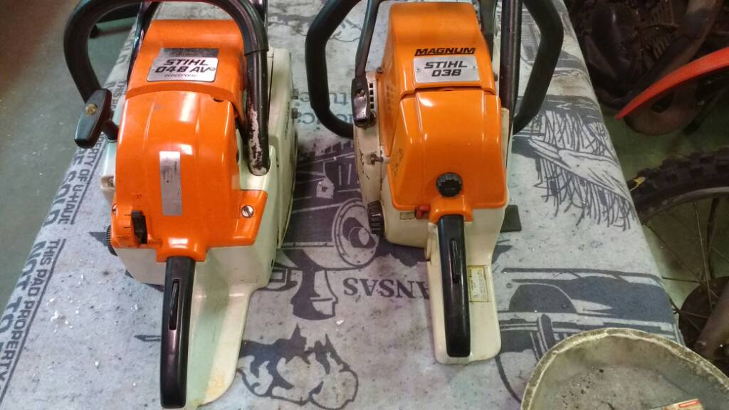

the 048 got here couple days ago. it is like new in n out. thanks to bbb for doin the leg work.
runs n oils good. comp feels healthy, no # yet.
7 digit sn, makin me think it's early one. has slot screws everywhere, and smaller of 2 carbs ive read bout bein used.
no pics but will get some soon, once it's ready to go w/b&c on it.
jug looks perfect on ex side [thru plug hole] & piston is clean. no carbon.
thanks for the responses, & ipl/manual. came w/brake kit, that needs installed, operator manual, nice windsor speed tip w/almost all the lettering intact.
thinkin this one has very little use.
not a "u suck" deal, but one ive been wantin.
