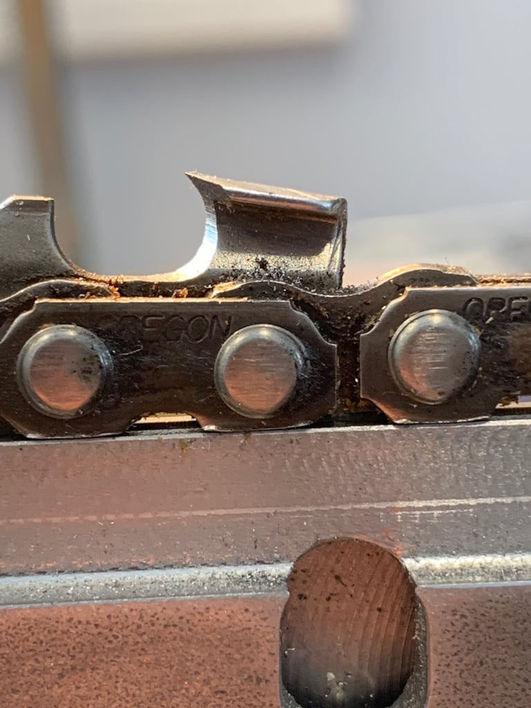

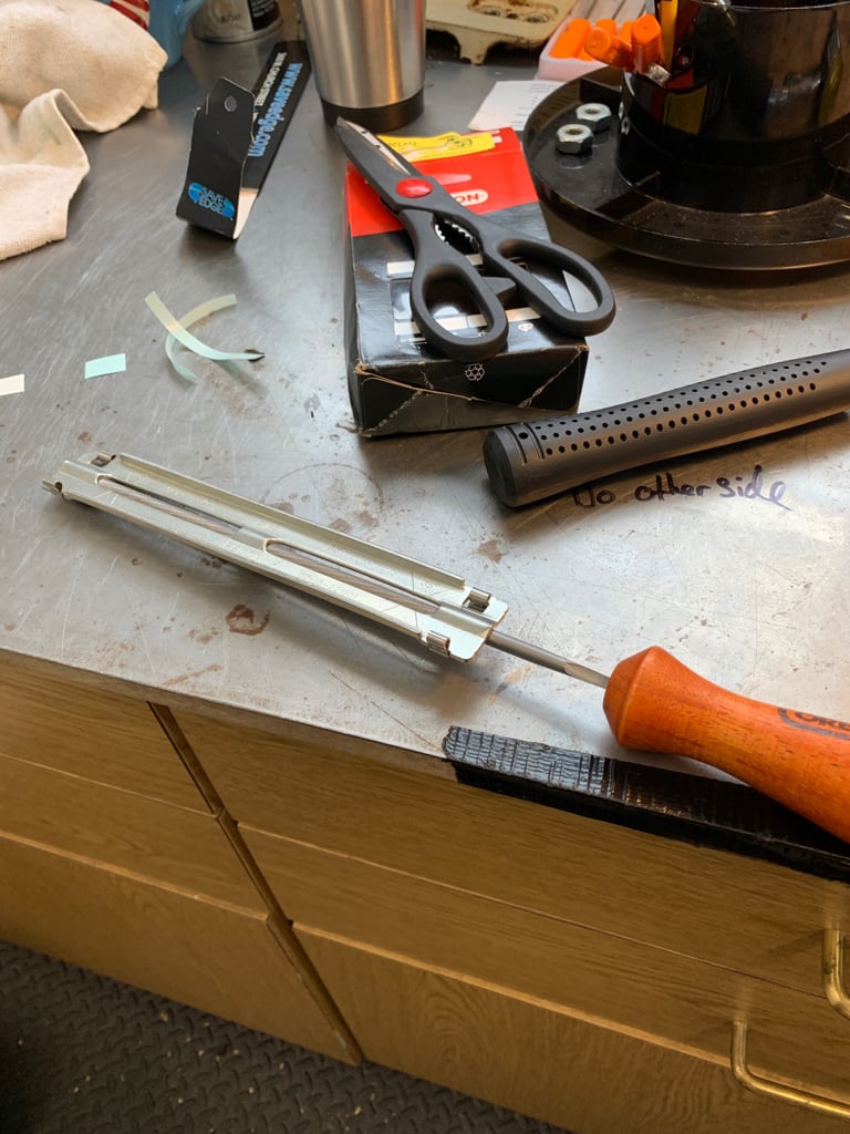

Ok here is my latest filed chain. 25degrees Oregon exl full skip. looks like my side plate angle is too much for hard wood? I would be running this on a 90 cc saw. Once we get back to the woodlot after this freaking snow I’ll be able to put it in some wood
Using 7/32 file in this guide

Lol. Use an older chain. Or send it out to have someone square grind it for you. Then learn the angles and go from there.
My save edge files are nice, but don't seem to last very long. [emoji57]
Looks great to me.
There are a few different things that will play into how well it will cut in hardwood on a 90cc saw; depth guages to deep it may struggle, length of the bar it may struggle if too long. Being full skip on a 90cc saw you should be able to run a 48 to 60" no problem if you can oil it lol.
I'd guess a stock 70cc saw would pull a 32" setup with a chain set up like that(filed and full skip) in hardwood no problem.
Looks real nice ,rakes look a little lower than i do ,like Philbert said ,one swipe on the front of the raker to round it off more will smooth out the chain some ,after about 4 touchups my general rule is 2 swipes on the rakes and a third to round the front ,seems to keep me about .025 for softwoods. ,That square takes a little bit to learn ,but is real smooth when cutting.
