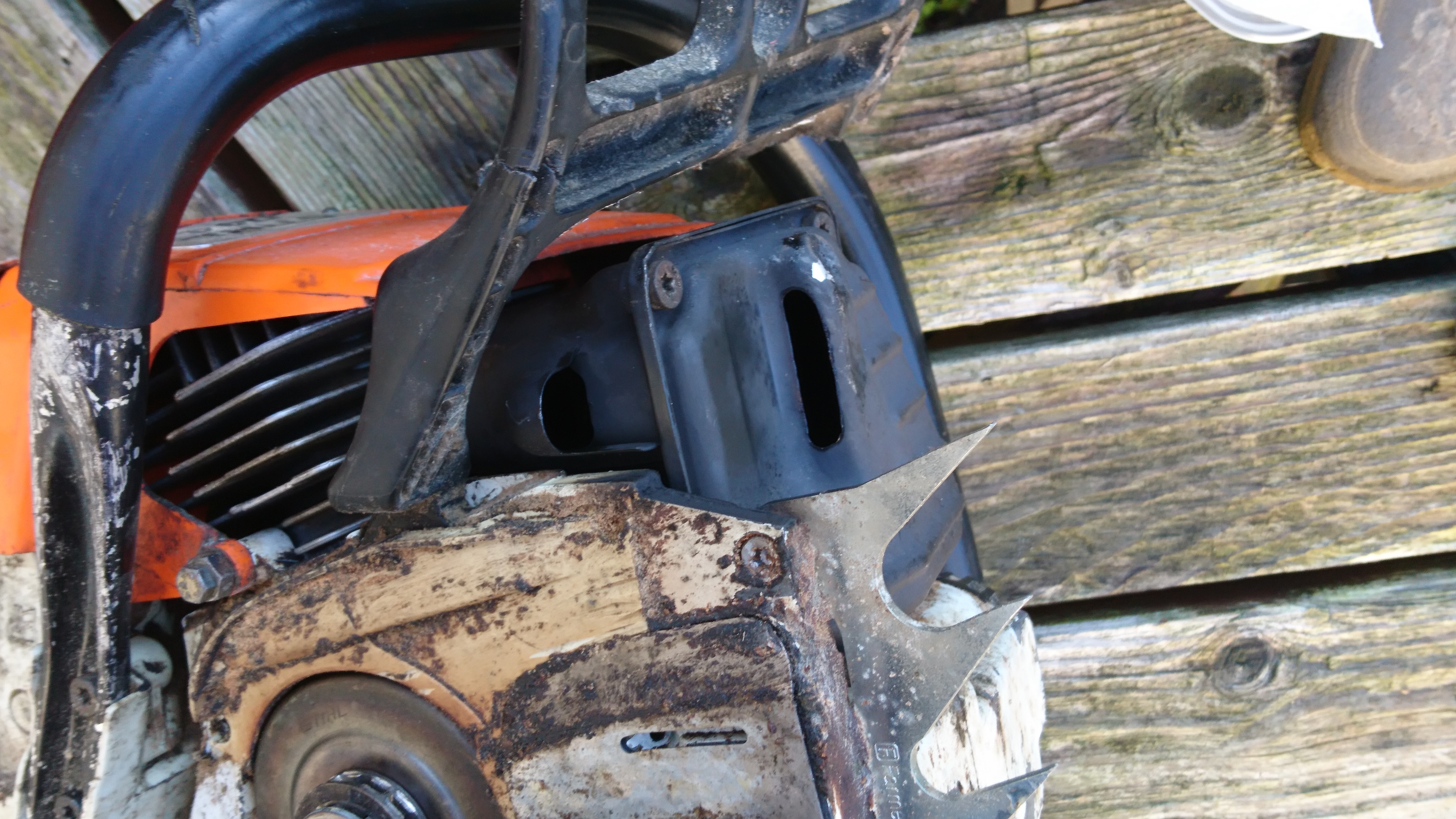

I've always wanted to make a variable outlet size test muffler with some kind of slide that can be slid open/closed to change the exit port size. It would be easy to make if you were Scarr, Moparmyway, Kunz or Deetz. It would give you good basic data. But it appears there might be a few other factors like dual ports, pipe style, baffle and exit location that have their possible effects to also consider. Interesting though, even Stihl themselves demonstrated the importance of outlet area when the Aussie delivered MS660's came with factory dual ports, the small HP increase was significant. My 200t is a different saw simply by removing the spark screen.

Good point. I think all of the TM saws have screened ports, which likely reduce flow by about 50% and should be considered by anyone running unscreened ports (the AM mufflers often don't have screens). Yet, the 461 in the first video still seemed to hit a point of diminishing returns.
I've also wondered if 2 ports on one side work as well as two ports (one on each side). Also, the difference of moving the port front to back.
So many things to consider … guess that is what keeps it interesting!
