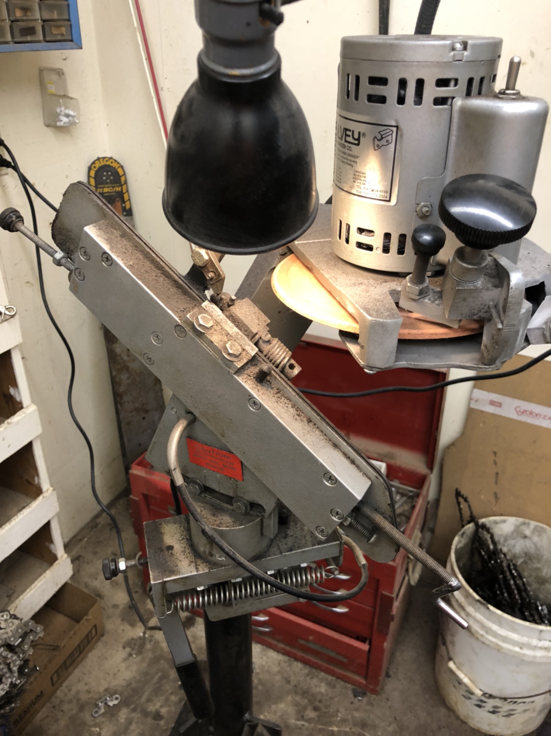

Only on my pro sharp the white wheel I didn’t care for
That looks just like Dan's setup. Nice but, not needed here much. It would sit or I would start doing square chain for people.
For me it’s part of it if I’m not running harvester I’m hand cutting oversize when I got broke in we were still doing poles and special order oversized fir.
