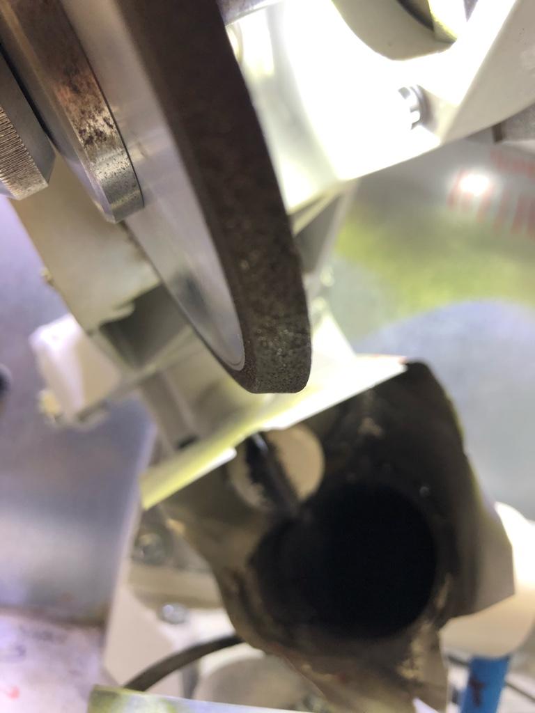

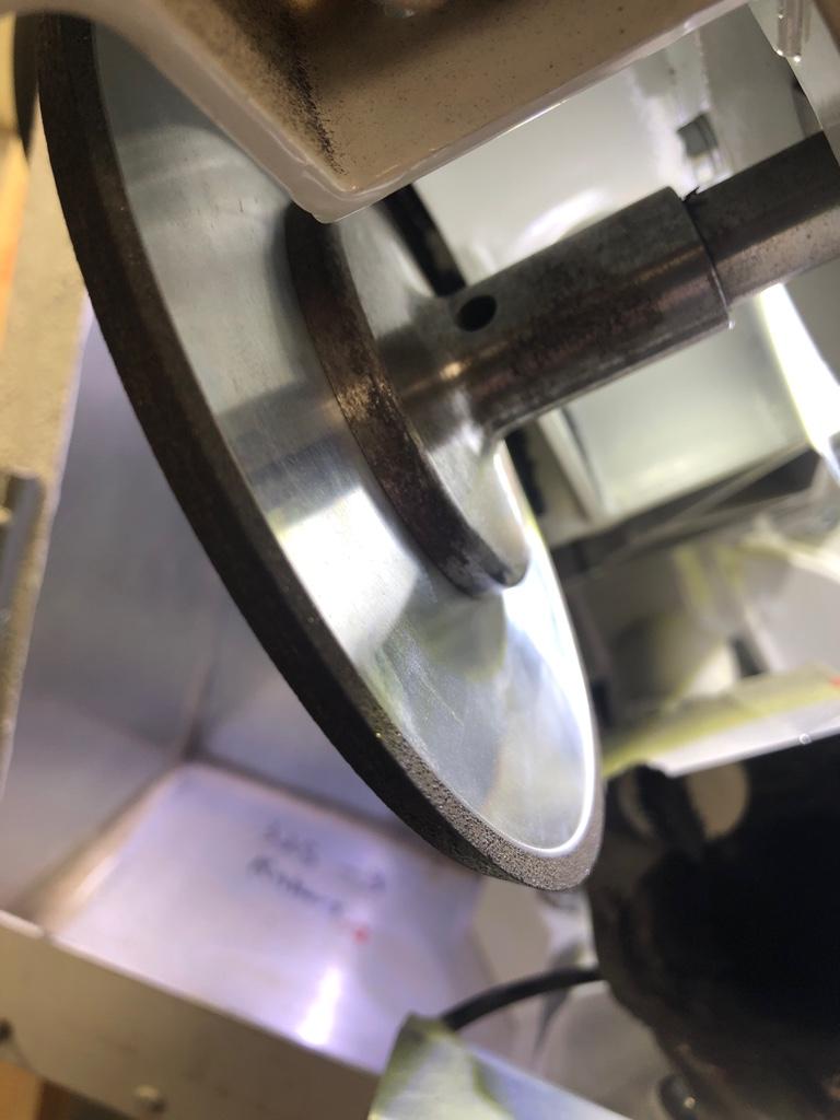

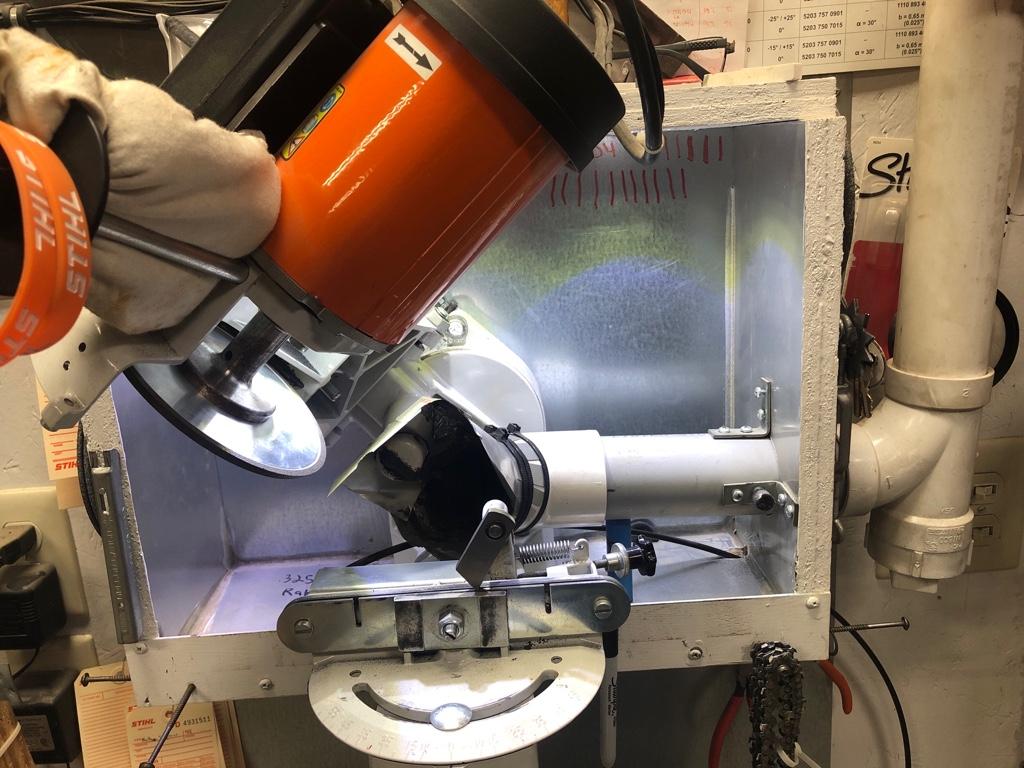

The best thing to do is shape your wheel the way you want it and send it to them and copy
I built this raker wheel in a larger diameter than what Stihl sends so I didn’t have to do as much adjusting down that was getting in th way of my vacuum system

Sorry Phil but all 5 of my wheels come diamond
did you get that from L&M sharpening? I have one identical

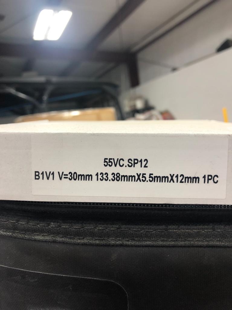

Dan here's the place to inquire about getting a square cbn wheel made .
