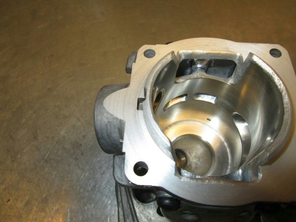

Here's a pic of Randy's beautiful port work on a 359 I believe. I kinda used it as a guide and my 353 runs pretty darn good.
I know that chick...
