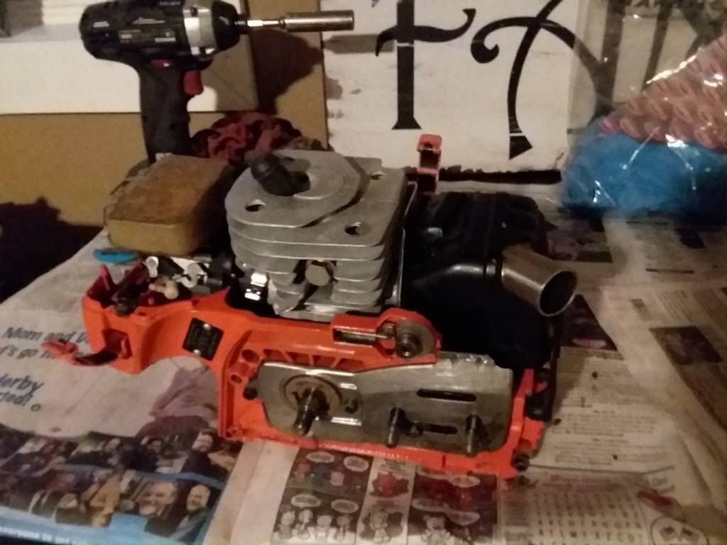

Got it together needs carb work

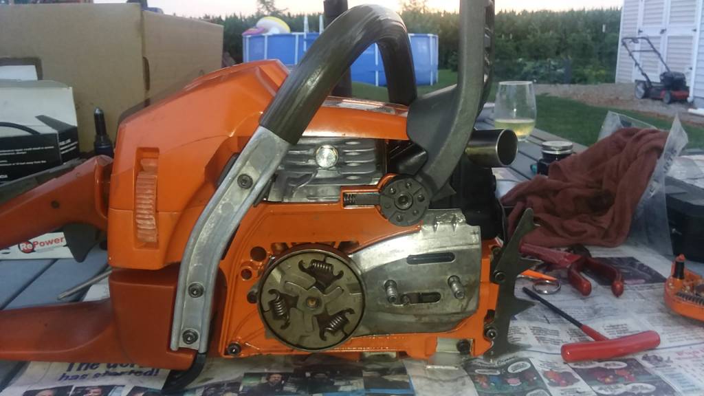

Last one to be built from the box of parts. Finished it around 9pm last night.
Used coil came from a newer member on CR-G that I hooked owner up with.
I think that makes 10 runners in these for him now.
