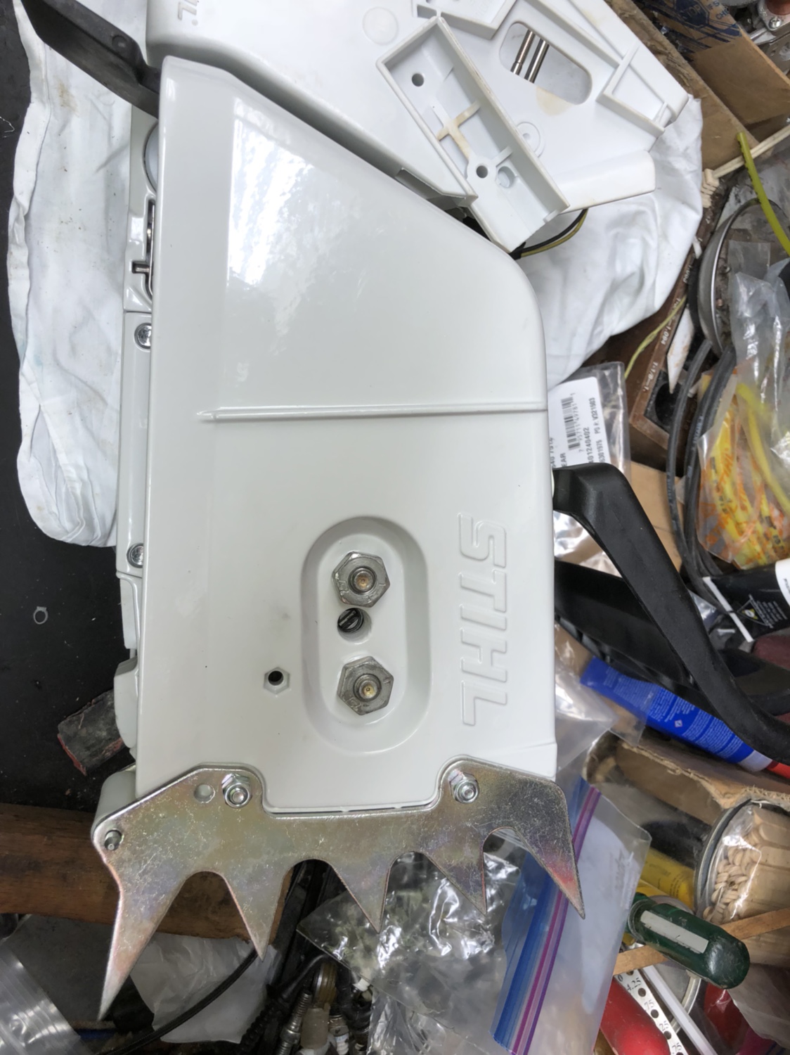

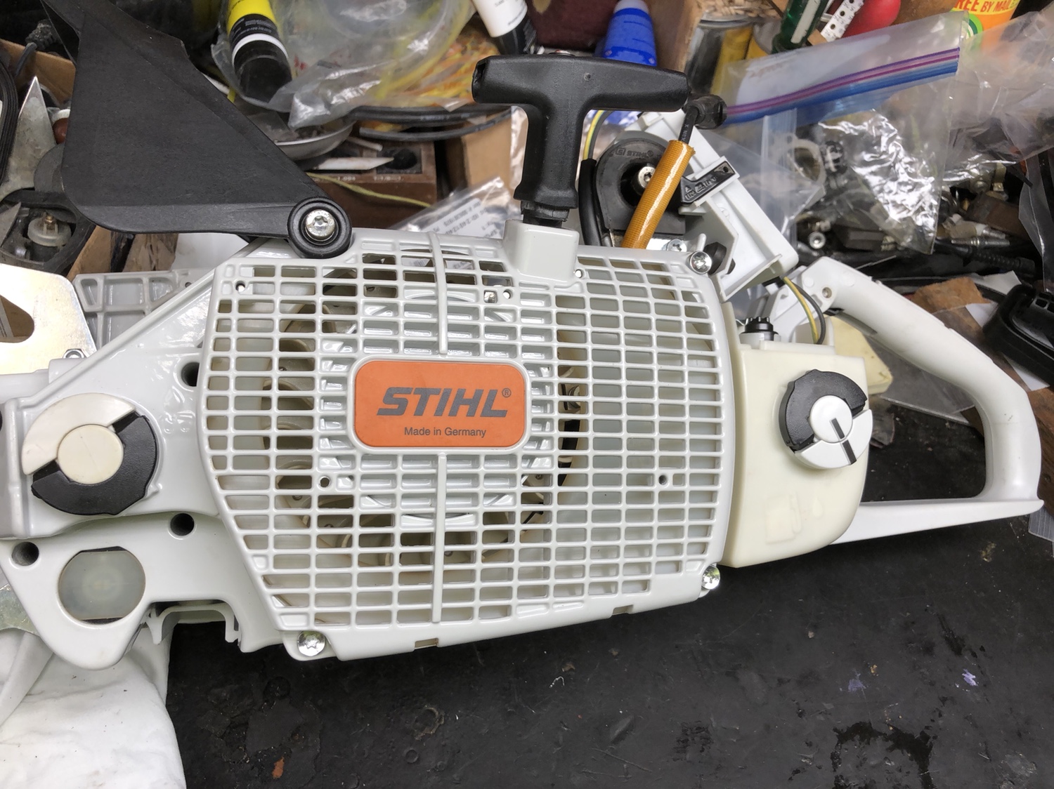

460 finished all oem except meteor piston hd 8 carb
Just dont know what im gonna do with it
1ade21c8ed3c2fcce1869d42f6e17bf3.heic
86200fce16cae41e8ba5e8d79fb96a8d.heic
132cf5537fe96804e2f7559391335ec1.heic
fc5196c23b580be76ef1e7599055ac40.heic
Ms 880 build new crank came in 50 days on order
Waiting on muff to come back from shawn
I got a piston bearing gasket and whole saw going to well know molester of juggs
I wont get it back untill oct
9ca57da8c8d38c80283530ac69c4fa91.heic
5f7ed6ccdfbdf53df81d098009511bf6.heic
2e8711793cde9eab41df3be417e90c87.heic
b84894277dd14eda1abb8e4d2362612e.heic
b5a72798c4172ef203b7cc284d97cb98.heic
