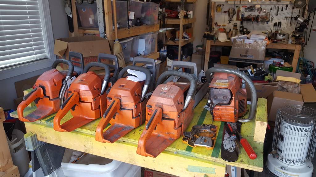

Benches are full!
Sent from my SM-G920V using Tapatalk
Ahh, you can squeeze another in. Plenty of floor space to store them squeels.

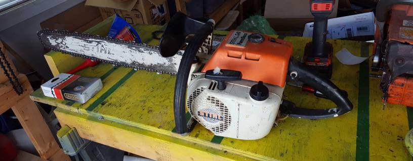

It’s alive!!! Probably gonna have to do seals cuz when I tip it to the starter side while it’s idling the rpms change some. Cleaned up well also
Pro sticker is there because I had a better filter cover from a pro 026
