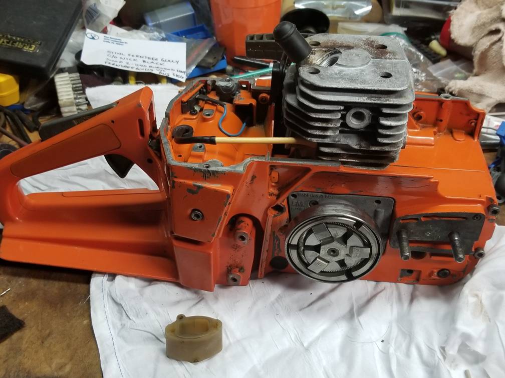

It's warmer today so I'm working in my shed/shop.
Stihl MS170 I bought two plus years ago. I bought in parts almost two saws, so I'm taking the best parts to build this one.
I do have a new bar and chain I bought on clearance at TSC.
So I layed out all the parts to make sure I have everything, and mocked up the chainbrake side to make sure it was all there and worked.
No IPL, building this one from memory.
Still need to make a split mandrel to clean the transfer of the bore, clean and reassemble the engine, and rest of the saw.
Low on cash so I had to use an AM piston and ring. Hope its okay.

Will try to do a tad with those two this week:
359, simple service, see if I can find a dealer with a used front handle bar and a top cover, and I need a dekal. Not sure if I gone port her or not, I'll probleby sell her.
357, will split her, and build her up with a new gasket kit, oem seals, SKF 6202 C3 VG104 bearings. If I rememeber correct I already put in new carb kit and fuel lines + filter. We're porting this one, it's a keeper.
And of course this one also miss a few parts like brake flag and a muffler.
