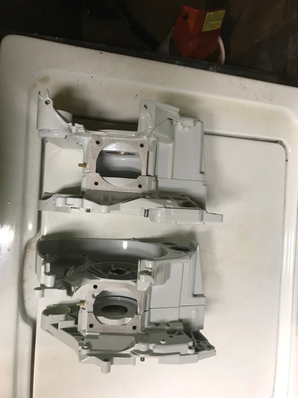

Glock37, beautiful work. What's type of abrasive do you use?
I use walnut shells in mine but only clean my parts, not remove paint.
80 grit black beauty it gives surface so powder sticks
Big and little Husky 3120 compared too 242
044 and 064
See why its so important too send clean parts i missed it too when i cleaned them in ultra sonic tank
Oil seeps out of crude when curing powder and oil stains finish luckyly its under muff never seen when together
044 and 064
Oh forgot 2 242 clutch covers

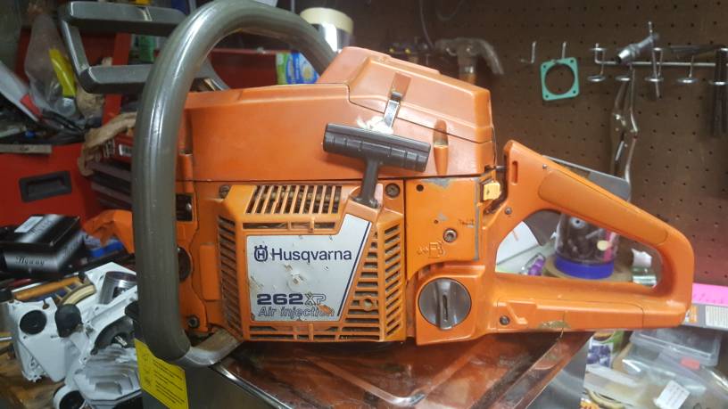

Never cared for these as I soon run a 60cc poulan. But guess I will check it over and sell it. Hoping just a ring stuck.
Has HDA87 carb. Why did everyone want that carb? Has the little trap door on tank too.
I sell them quick as I get them in.
View attachment 96711 View attachment 96712
262xp?
I have the opportunity to look at one tomorrow and own it if a deal can be had.
I’m under the impression there is a more desirable version with the HDA87 carb and KS cylinder.
Can anyone help me out on what to look for on the cylinder?
Also wondering ballpark value assuming decent operating condition.

262xp?
The KS cylinder I have does not have a decomp. No sure all of them are like that but that's what mine has. Picked this tonight. 120 carb and decomp cylinder. This one needs some attention to the back two holes for the top cover. It also needs bath!

Cool on info. My other 262's had decomps. This one doesn't have decomp and 87 carb. Maybe this one will run better then the others. Like said just soon run the 60cc poulan because they 262 didnt impress me in past.

Just SMH. Easy fix on yesterdays 262 pick. Piston barely scuffed and ring not stuck. K&S cylinder and piston.
Good thing I got this and not the other guy or someone else IMHO.
Missing circlip and no base gasket. Low psi = no base gasket or sealant was used. :risas3:
