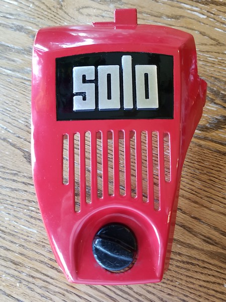

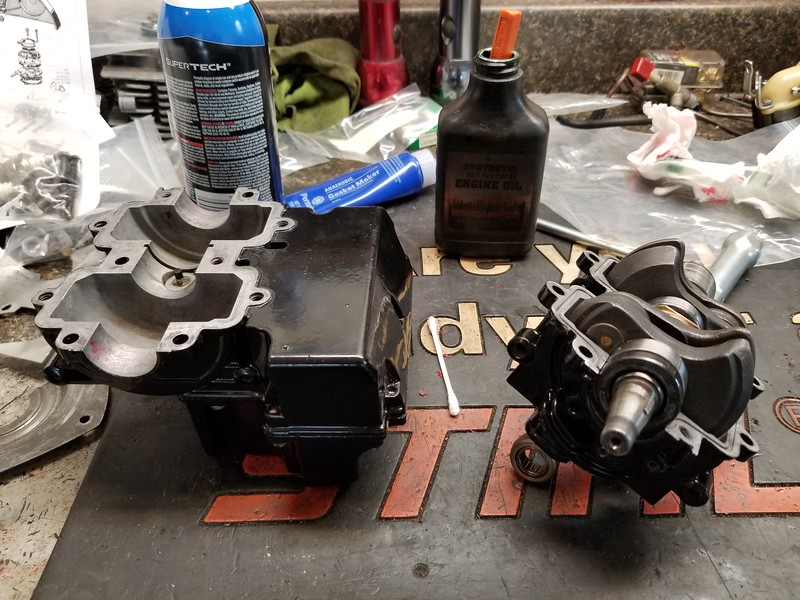

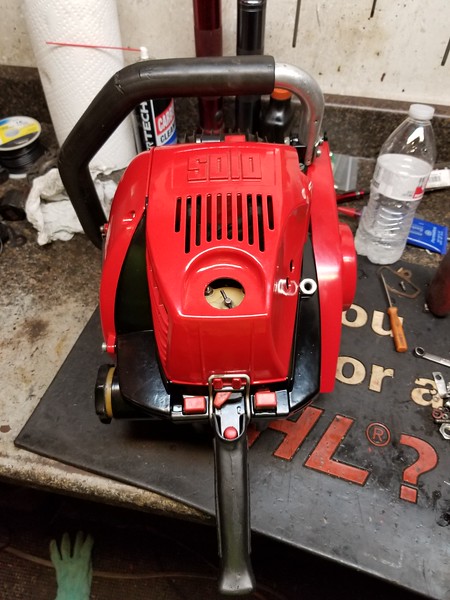

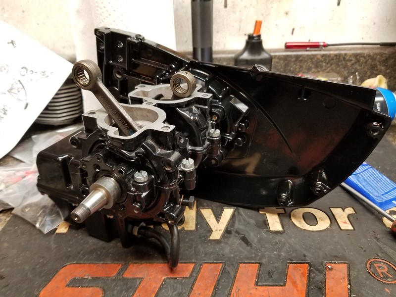

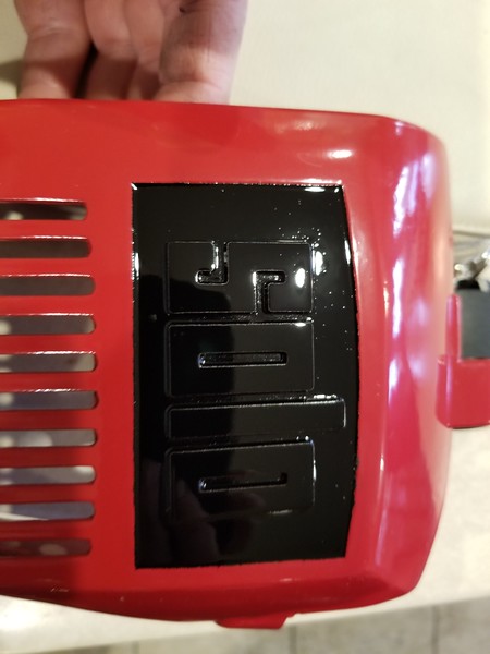

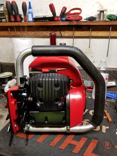

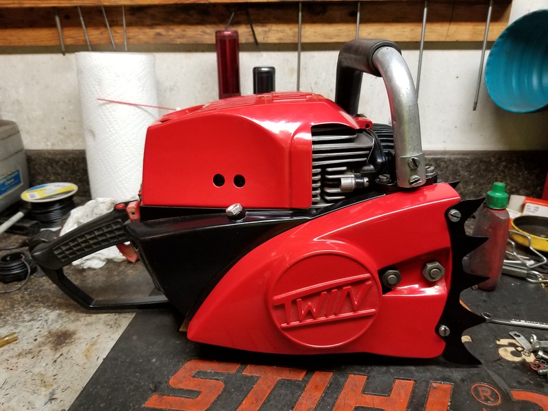

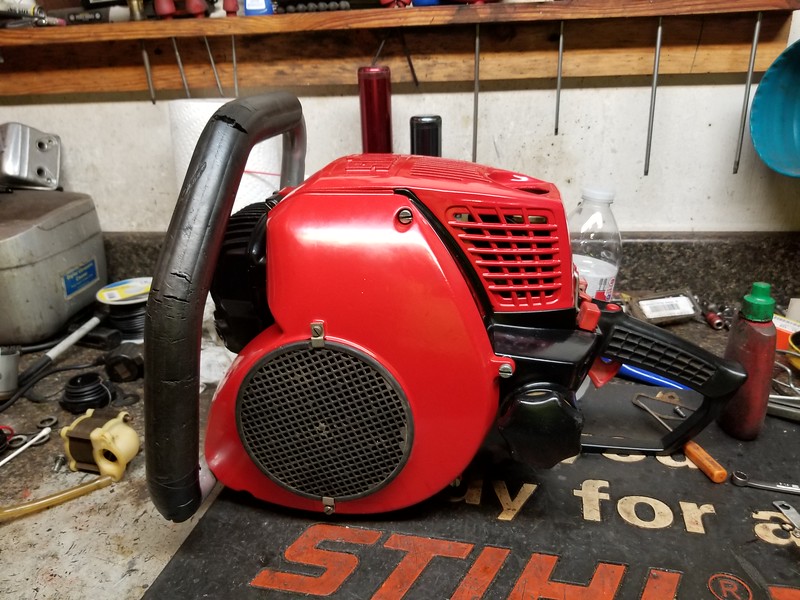

The first of my Solo Twins finally went back together this week. I have a second one that has the very rare 110cc topend. I'll be doing it ASAP while the assembly is all still fresh in my mind. This one took about 12 hours to figure out and put back together!
My great friend Rob stopped by to see me, so he got the honors of firing it up for the first time, since I'm recovering from surgery.
That's just badass
