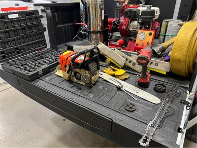

It’s been a while since I’ve had a clutch off. It still hate them.
Greased the bearing, it was dry. Kubota multi-purpose grease was not my first choice, but it was what we had.
New sprocket. It was time. It looks like Stihl has changed the design of the 3/8-7 pin.
Cleaned it up. Noticed it’s going to need a chain catcher. I’ll get that another day. We already made some runs and it’s time to train somebody.

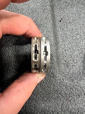

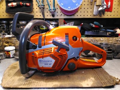

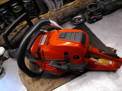

Got this 562 for about an hour and a half worth of work on some other saws for the owner of a pawn shop.
2020 mk1, piston was lightly scored up probably from straight gas. My guess was the first tank they ran through it was probably straight gas, based on the condition it is in (looks almost mint).
Today, I cleaned up the cylinder, modded the muffler, and threw a Meteor piston kit into it. Cost: $55 + $75 worth of work.
