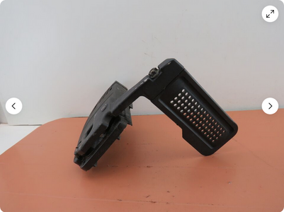

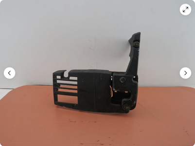

old 040 - those flag style brake handles on the 600 Series saws are getting hard to find. I discovered recently that the brake handle from the PM10 Series type saws will bolt in place, but are about 2" taller.

Hey Mark, that's good to know. I did see a PM 655 get parted out recently on eBay. I noticed that the chain-brake assy looks just like the older/first? style, but has a small bolt on flag rather than the full wrap flag.....Oh, I used the clutch cover/brake assy from another 610 I had here, the saw originally had the older style but was broke. I'll use the one that's on it now until I come across another.
Screenshot 2024-04-04 at 12-18-24 McCulloch Pro Mac 655 OEM Chainsaw Brake eBay.pngScreenshot 2024-04-04 at 12-19-10 McCulloch Pro Mac 655 OEM Chainsaw Brake eBay.png

The brake lever on that one will also accommodate the wrap around brake handles found many of the 600 Series saws. In fact, you can cut and shape the wrap around brake handles to make a very workable substitute for that type of flag.
