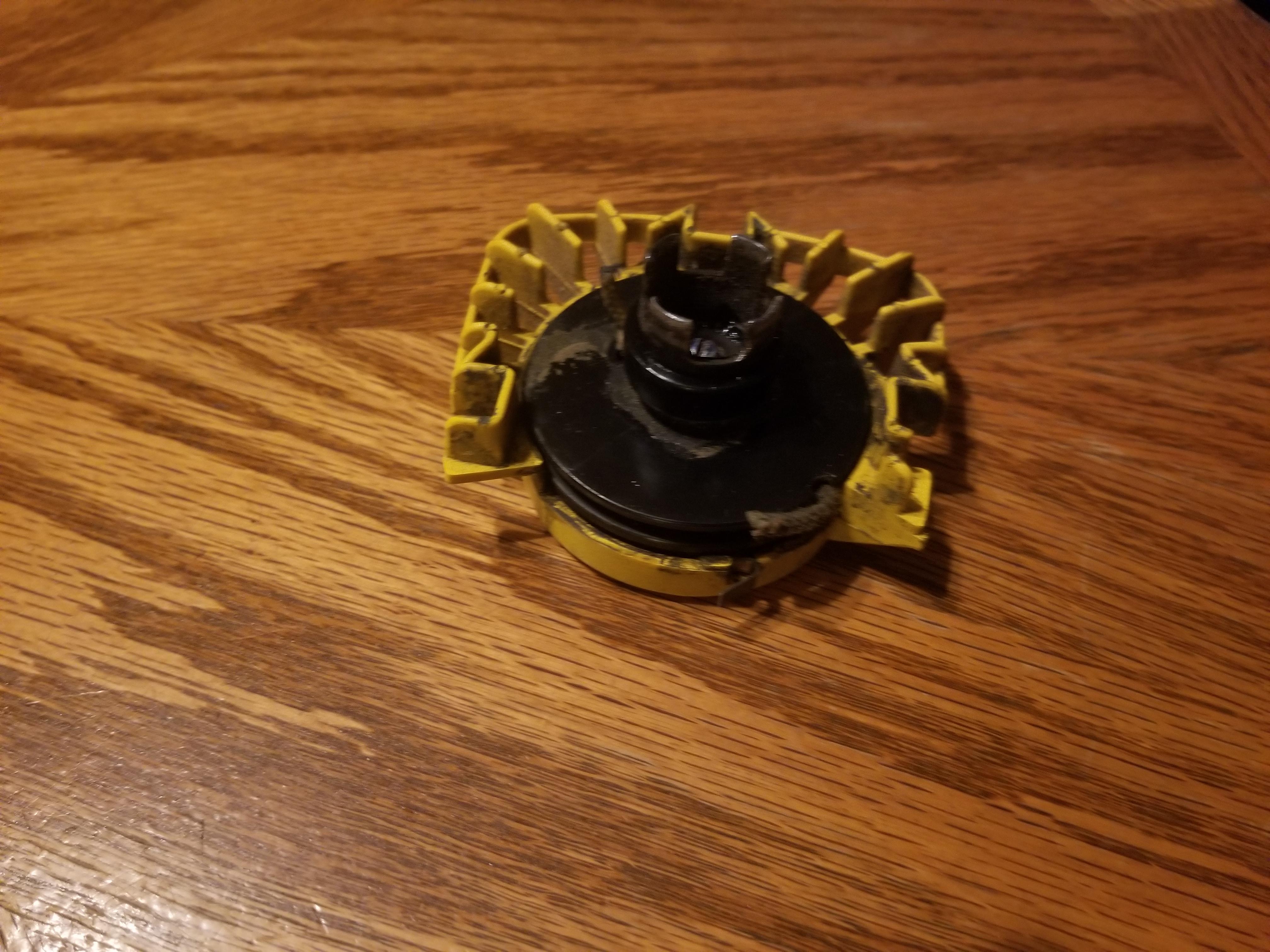

Attempting to fix the recoul on my mini mac. The plastic part broke in the middle so i glued it in.

Ok. No problem. The updated tan plastic spool will need some modding possibly. The flywheel is different between the engines that used the spool like yours and the later version. On mine they were not interchangeable because the crankshaft was a different diameter and taper. Mine is a real early model that came with 1/4 pitch.
The two flywheels use different pawls that I couldn't remove.
Ok never new that. It came off a 330 i think it was. Wonder if I could just swap the flywheel too if they dont interchange? If the flywheels are the same?
