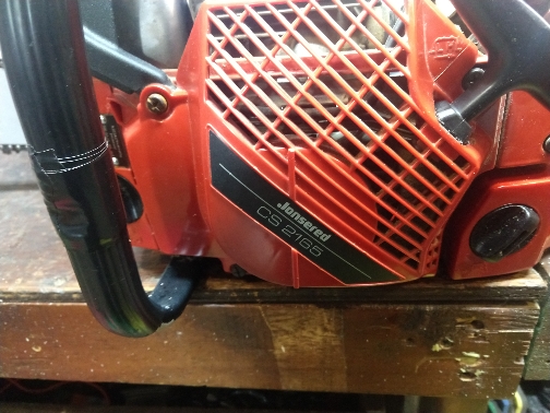

Must resist....starts easy idles real nice.
Why in the F am I trying to see how to defeat the limiters and looking for ways I can open up the muffler before I even run it in wood.

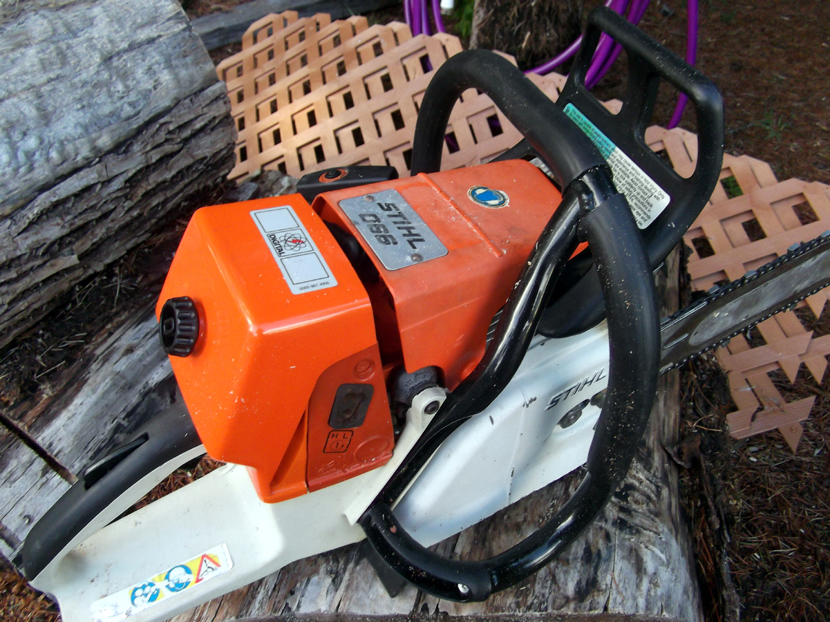

I spent part of the holiday weekend working on my car, and then I built this pig:
I used a Ducati coil that came on certain Stihl 026 saws and gave it a few degrees of timing advance, along with an
early WJ-48 carb. Cylinder is an almost period correct mint bore jug with a new Meteor piston and rings.
If you guys haven't treated yourselves to one of these, they run pretty darn good.

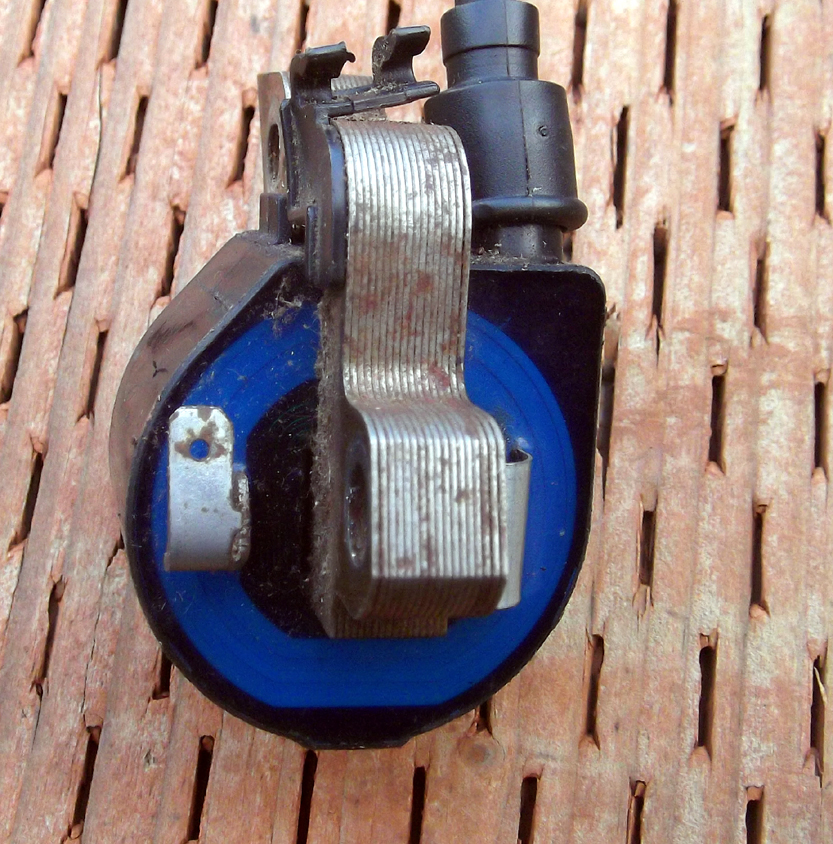

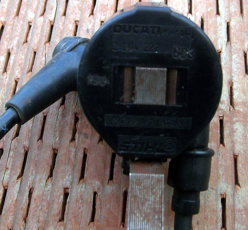

Were they all blue?
My brain was thinking they were a hazard yellow/orange color...
I've seen some Ducati coils that came in Efco/Olympyk/Oleo-Mac saw that were orange or yellow.
All of the ones I seen in Stihl saws are blue on the back. They seem to like being advanced more than the IIDA/CDIC coils.
My Stihl Ducati is all black I think. I gotta check.
It might be an early SEM - Stihl contracted with SEM for a while for coils on several of the small and mid-range saws.
The SEM coils run good but have a high failure rate.

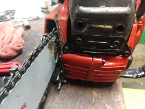

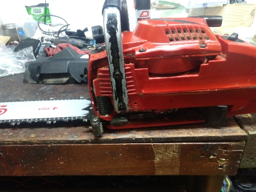

I need to get my 066 back together one of these days.
I've been debating getting the cases powdered and that has me stalled out in it.
I have never been disappointed that I got cases powder coated. I have been very disappointed after a build that I didn't get them coated!
They are really not in too bad of shape but I'm kinda picky....
And it's already completely torn down...
So now would be the time!!
