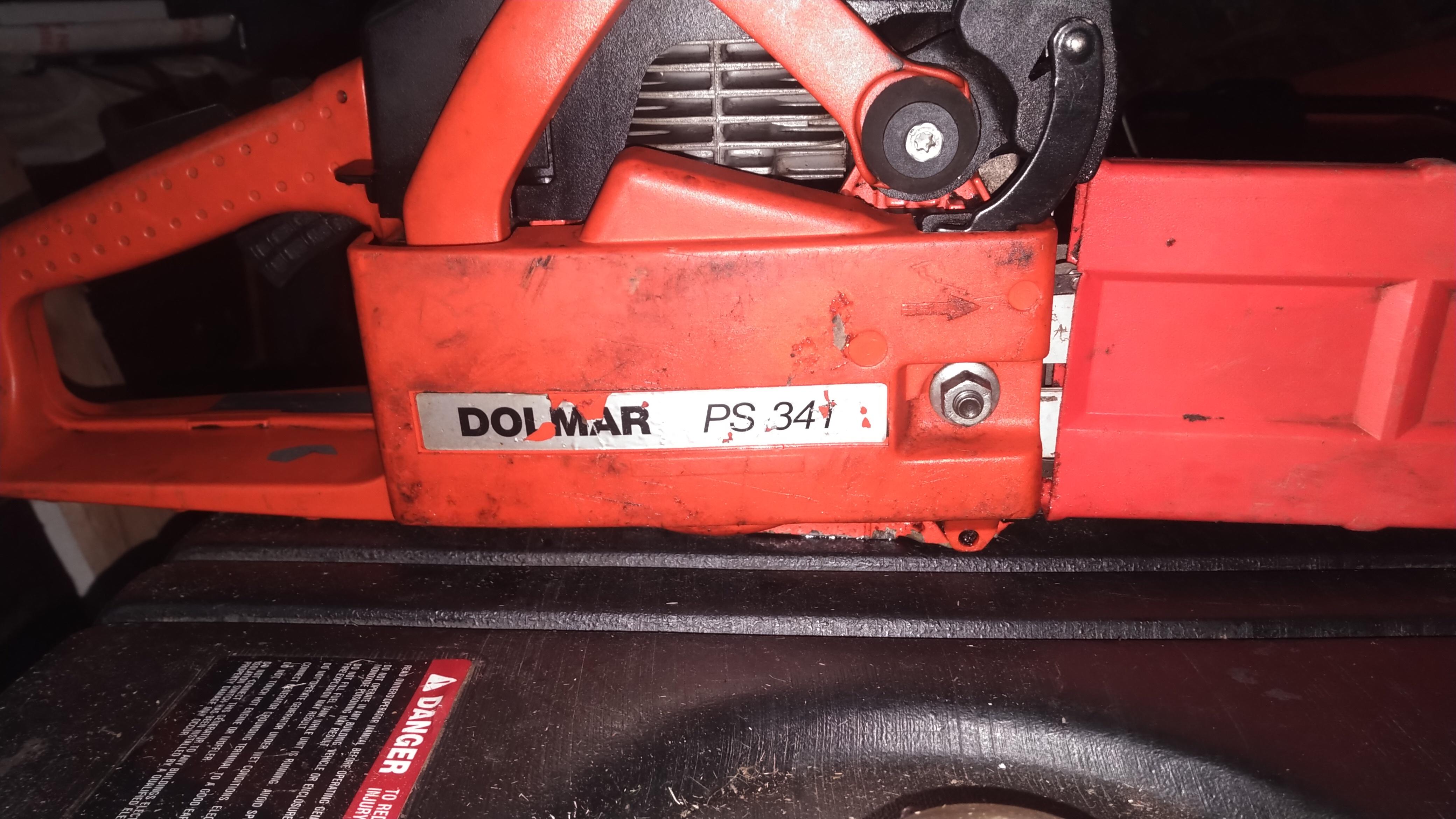

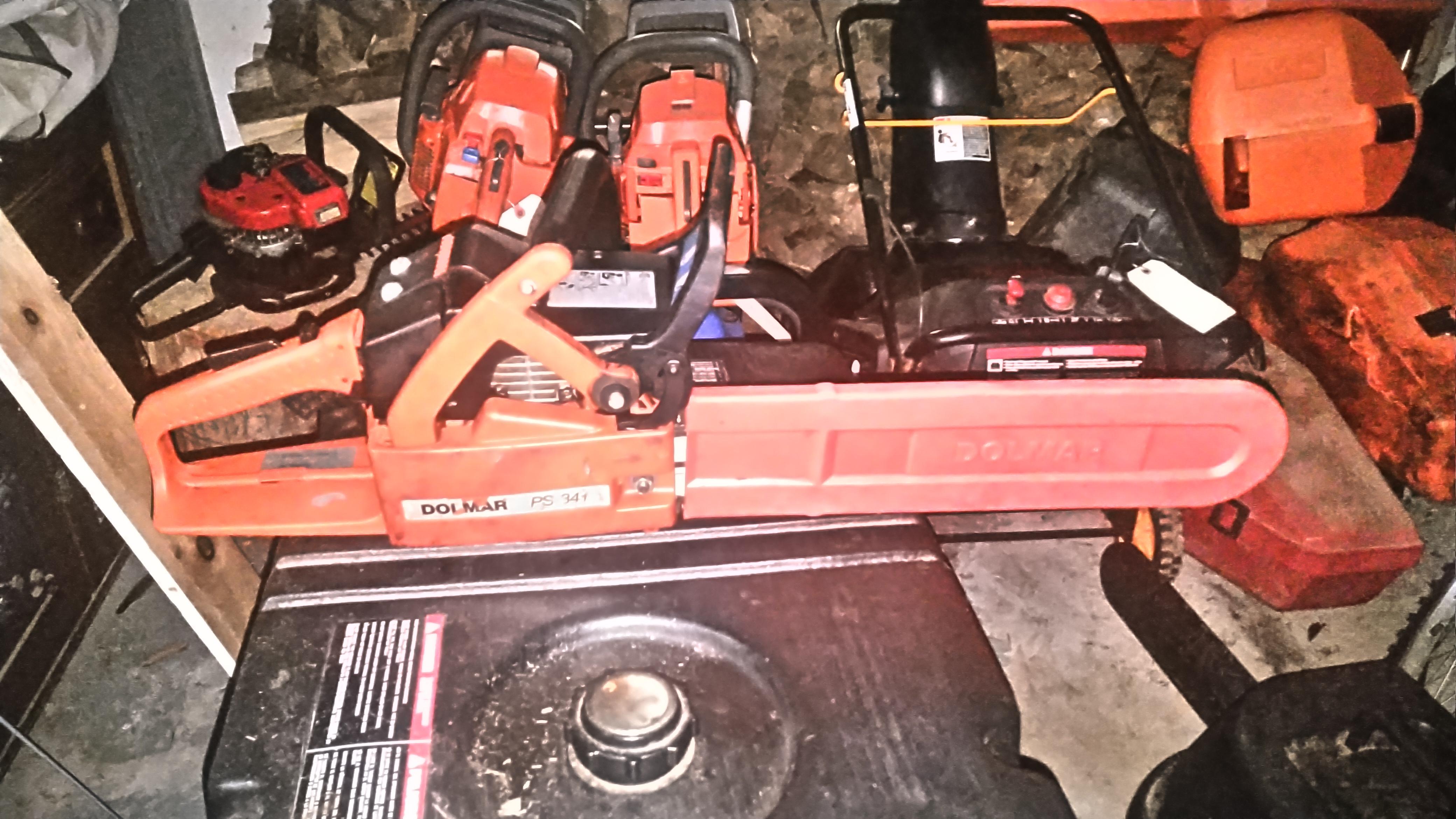

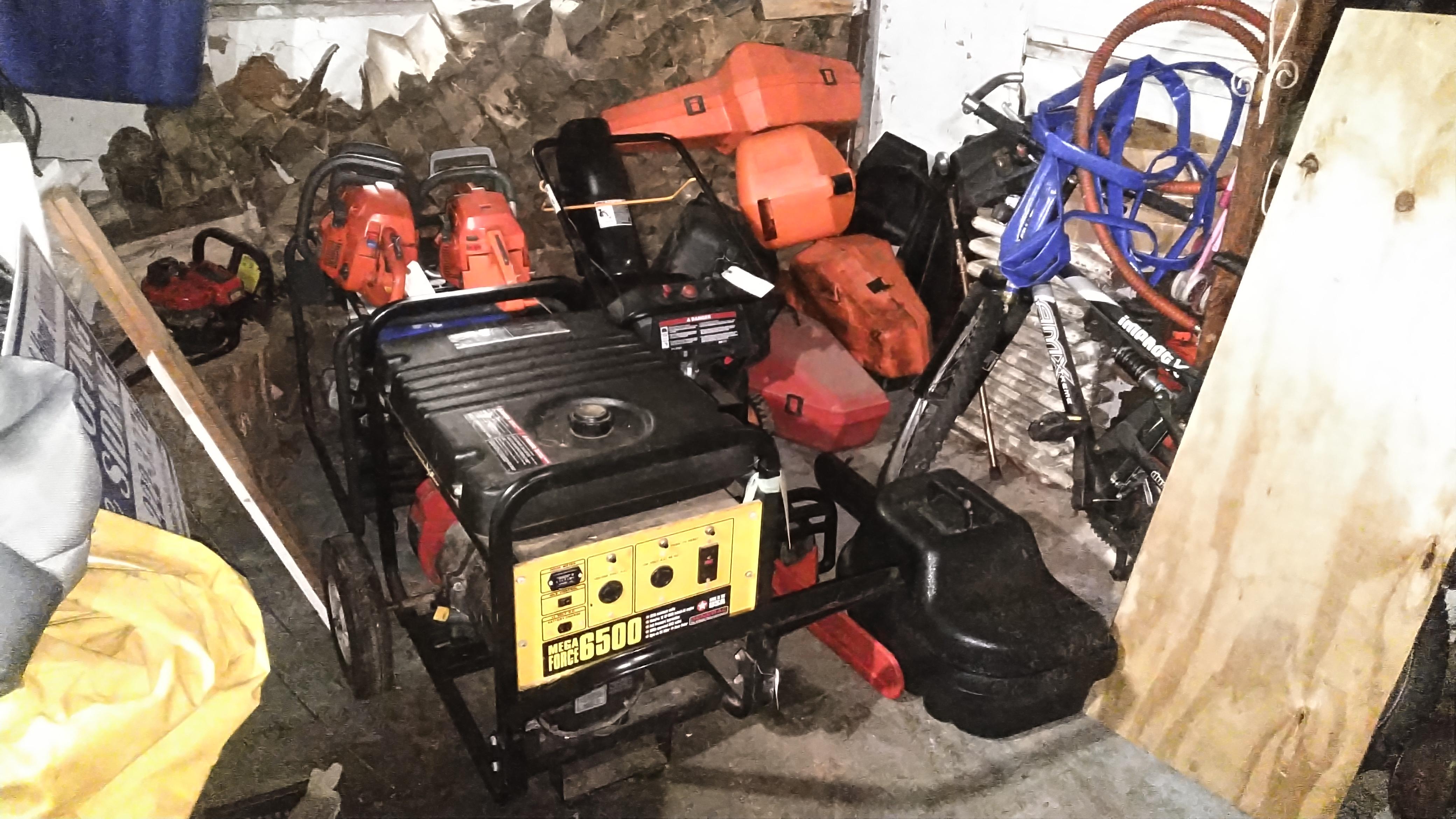

Dolmar ps341 dropped off for a get running and service. Seems in nice shape.

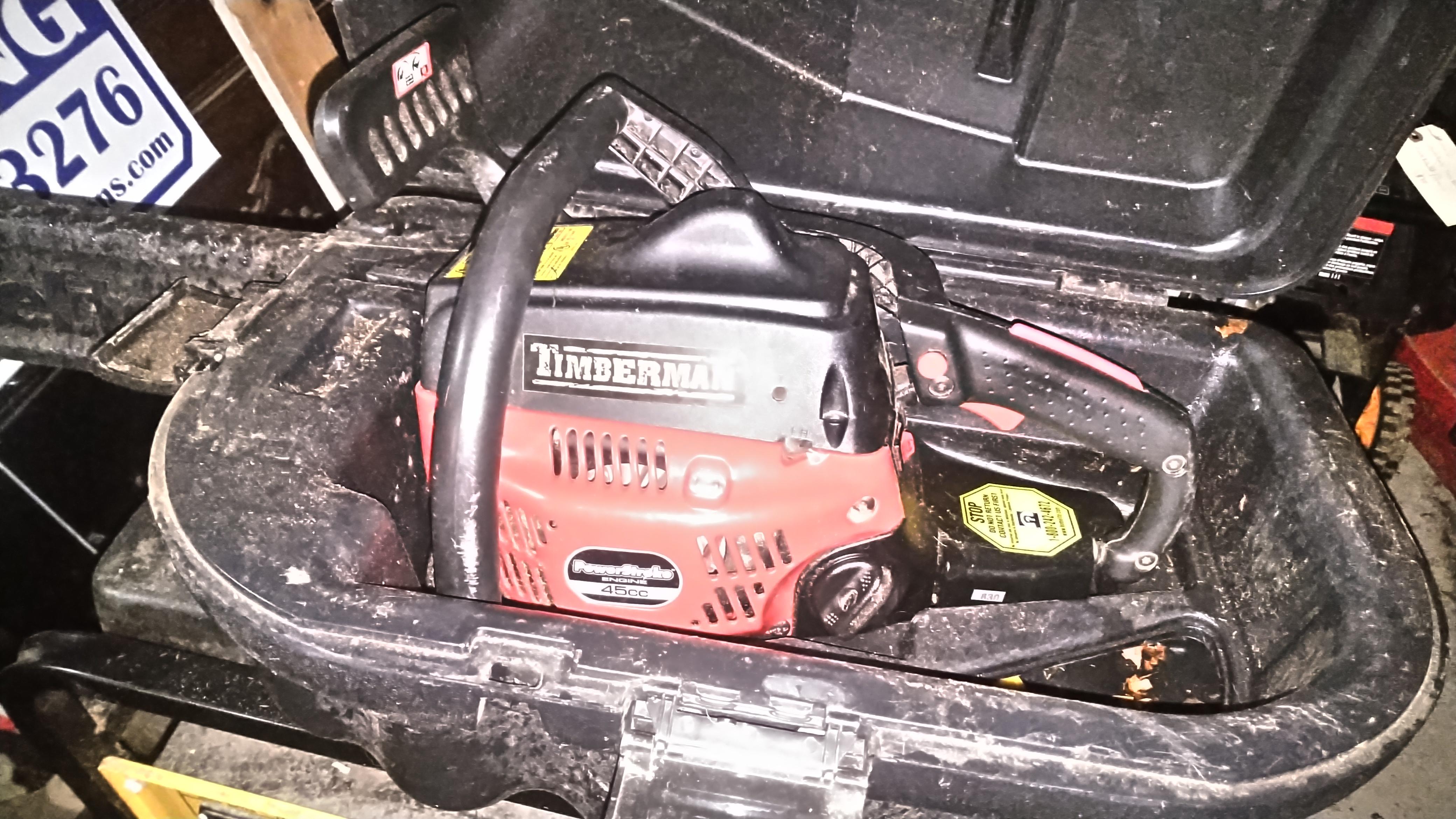

Also had a pos Homelite Timberman dropped off by one of my mom's friends. So far I see it needs a recoil rope.... hope that's it.
Starting to setup my completed repair/waiting parts/needs to be looked at section of the garage.

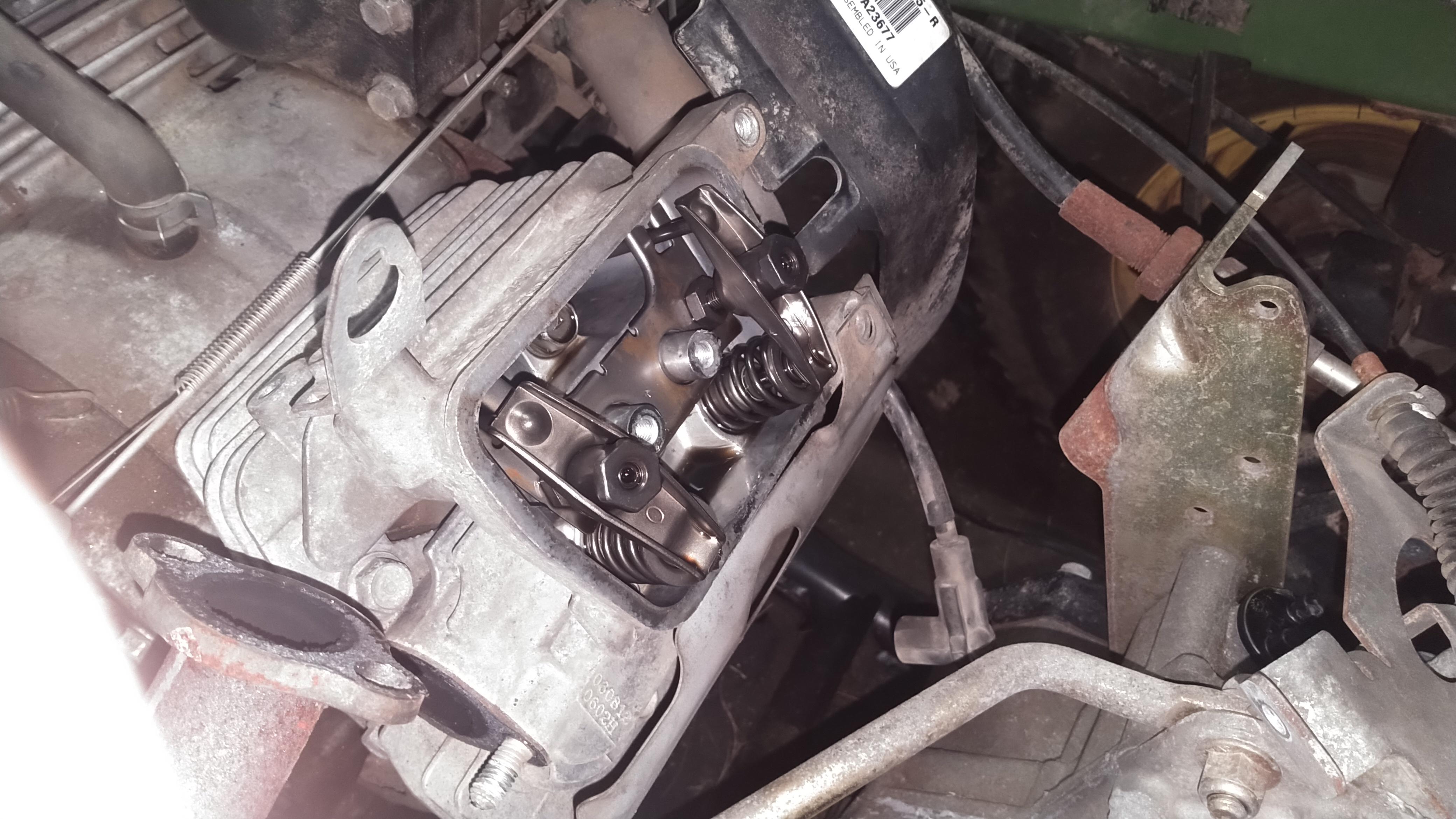

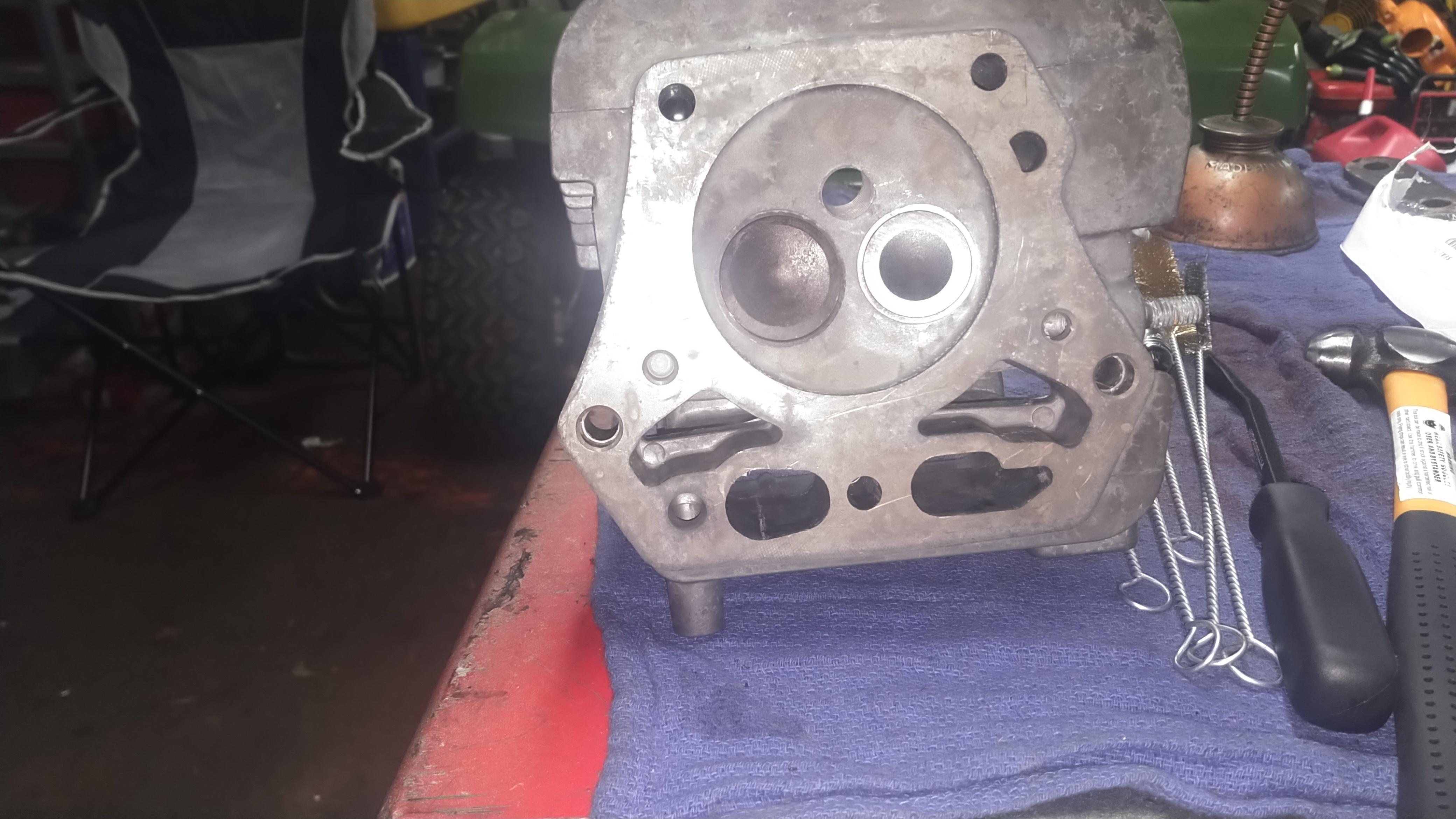

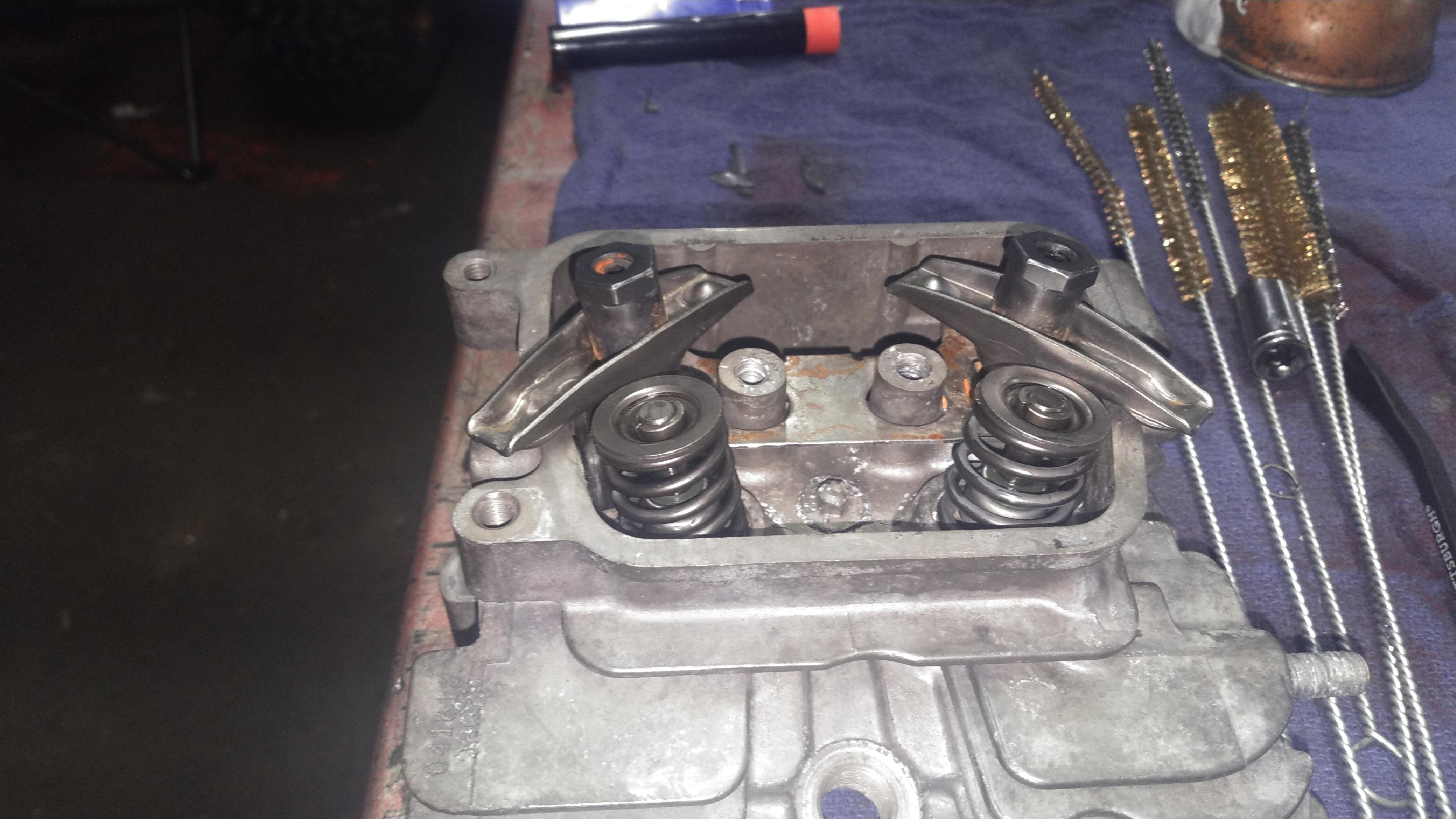

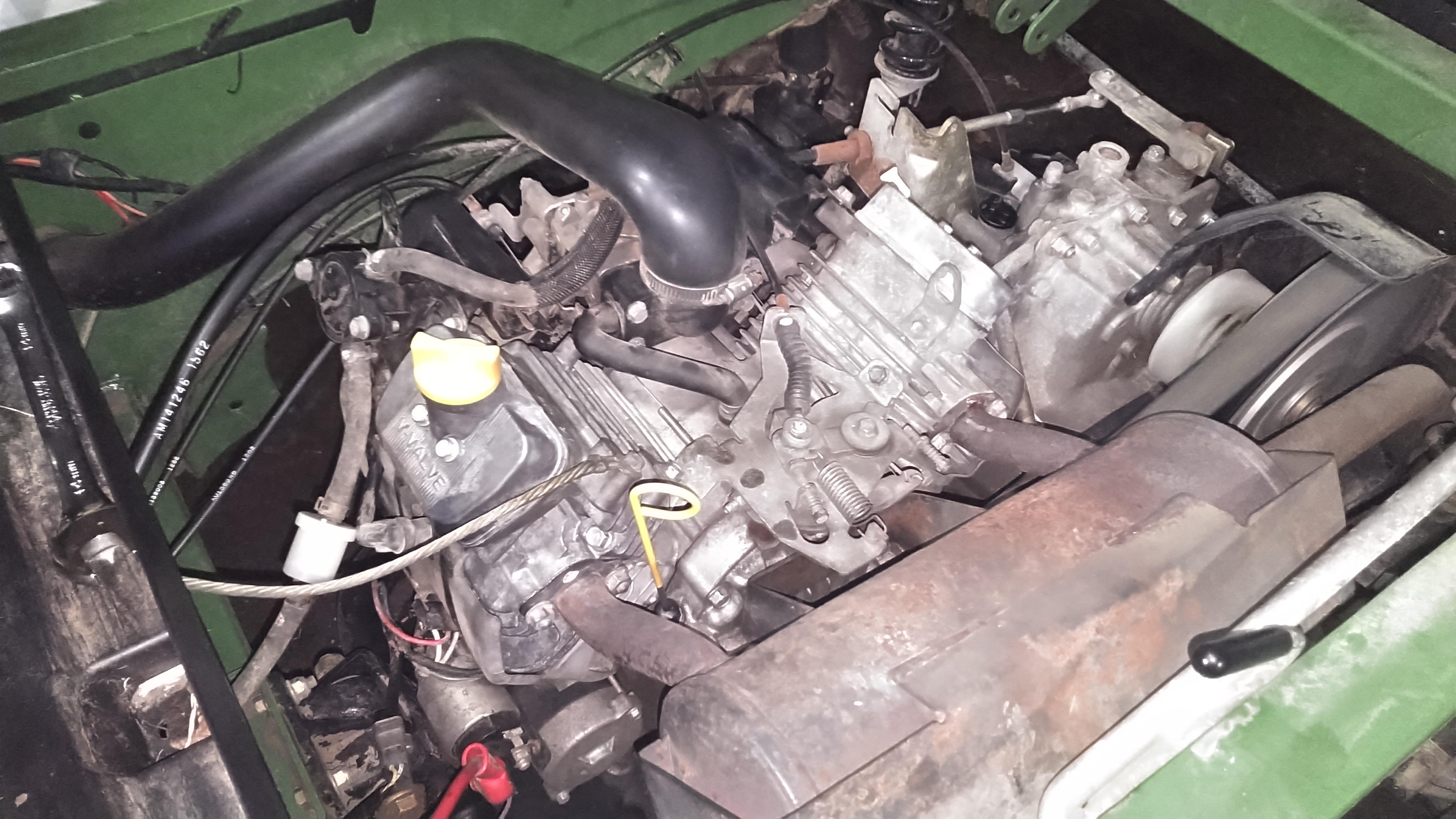

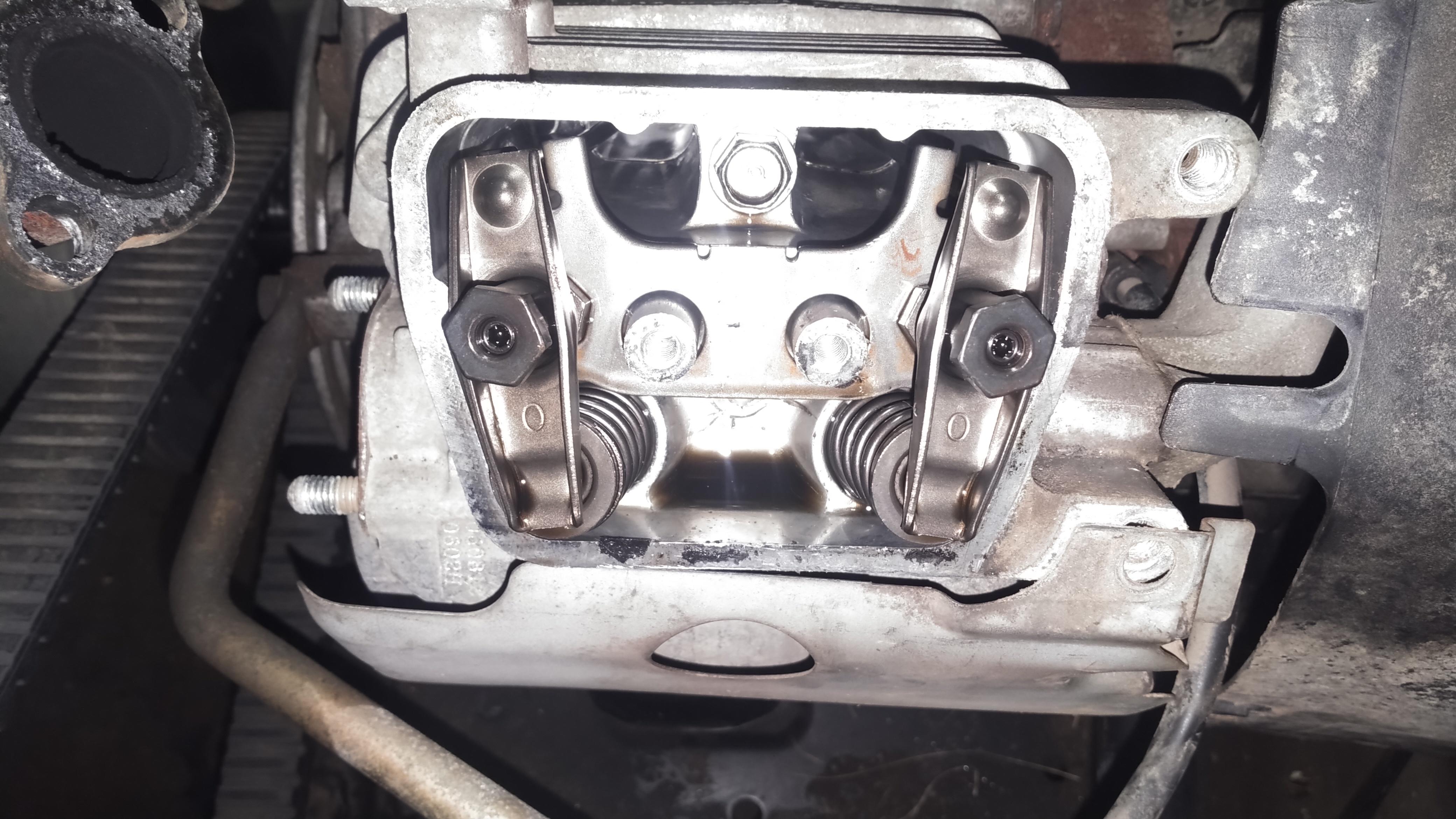

Kawasaki FH601 head reassembled, reinstalled, and lightly torqued. Tomorrow I'll bring my torque wrench home from work and do the final torque, valve adjustment, assembly and fire her up! Pulled the other valve cover and checked/adjusted the valves. They were pretty loose.

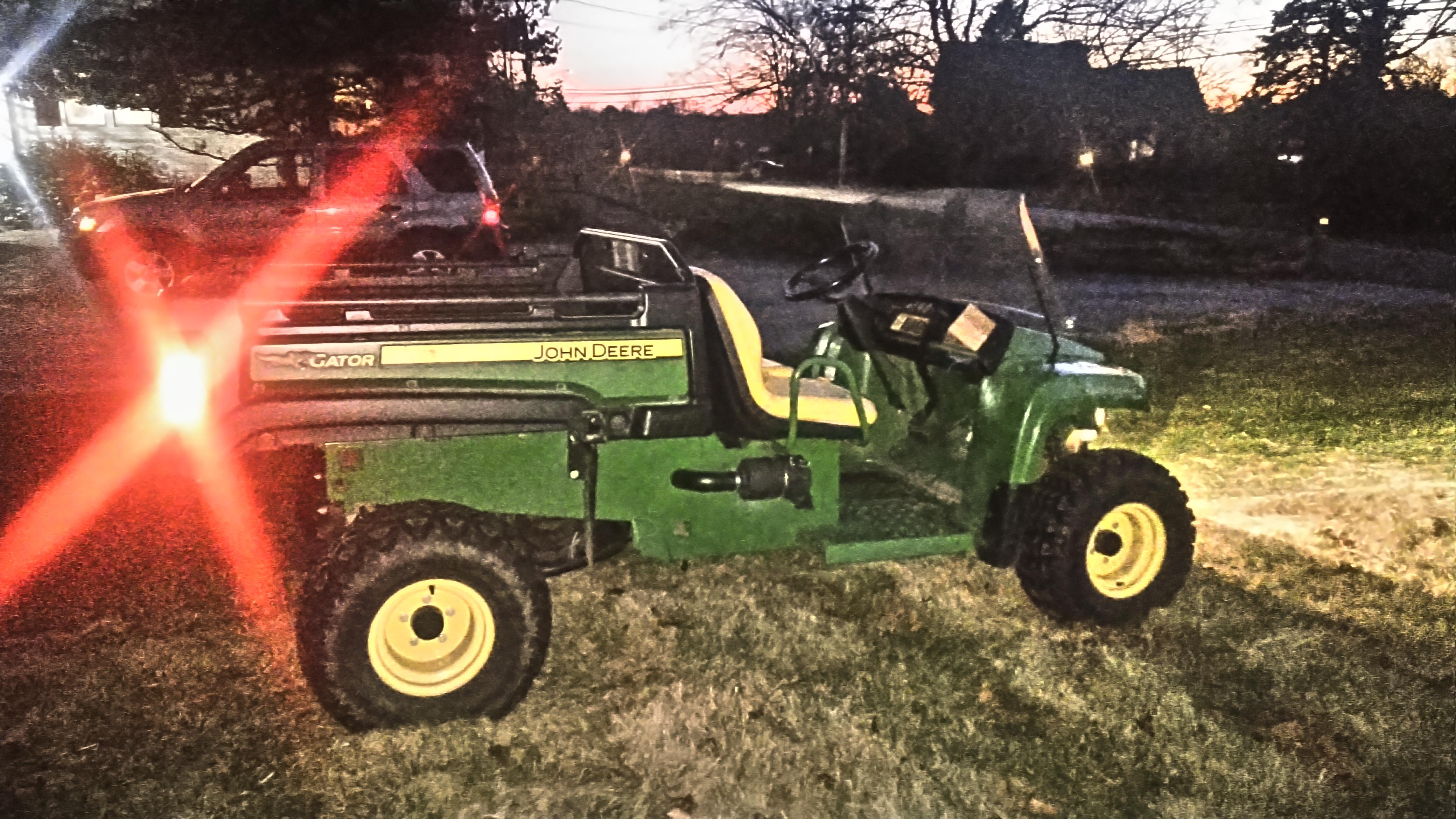

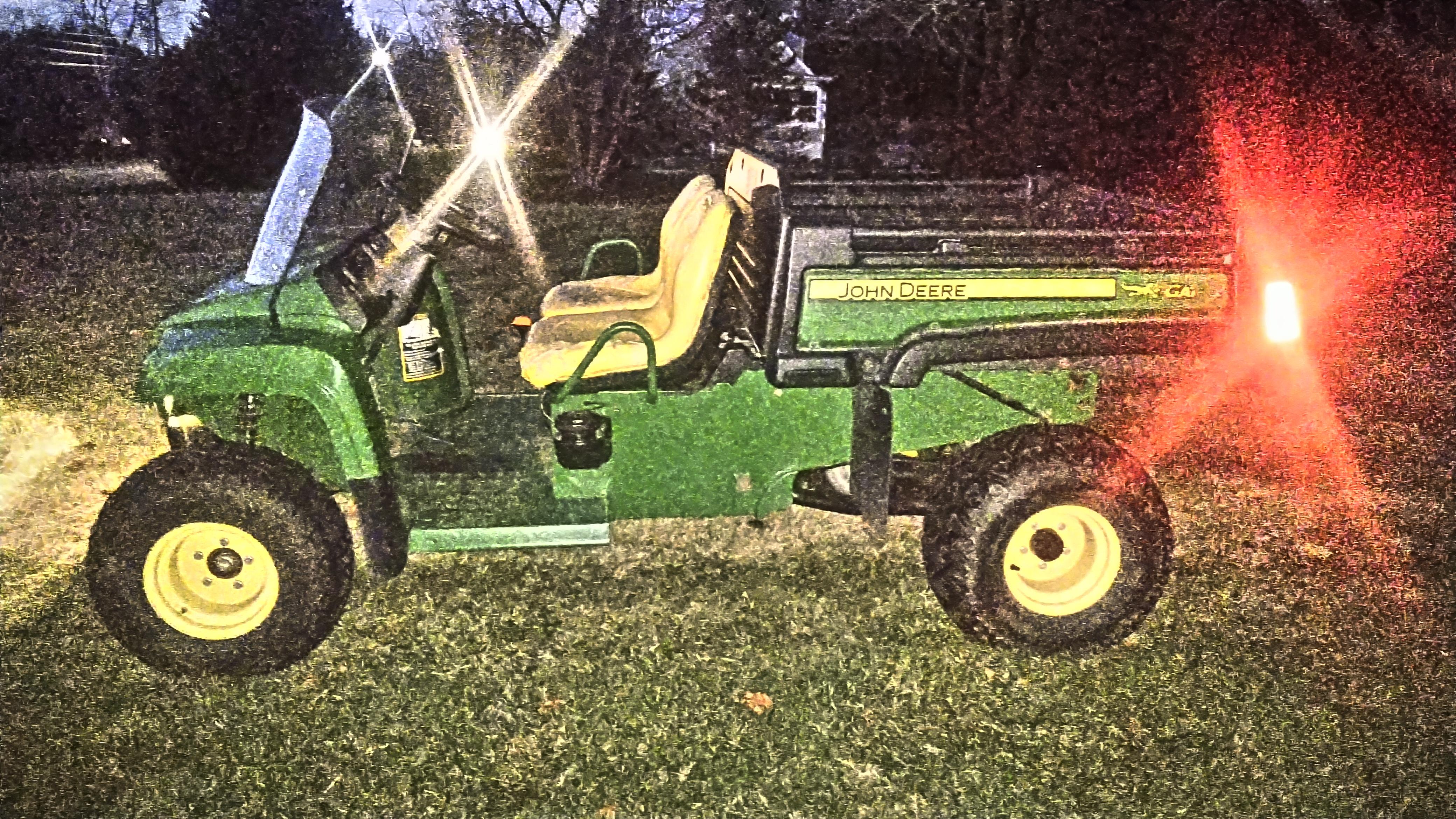

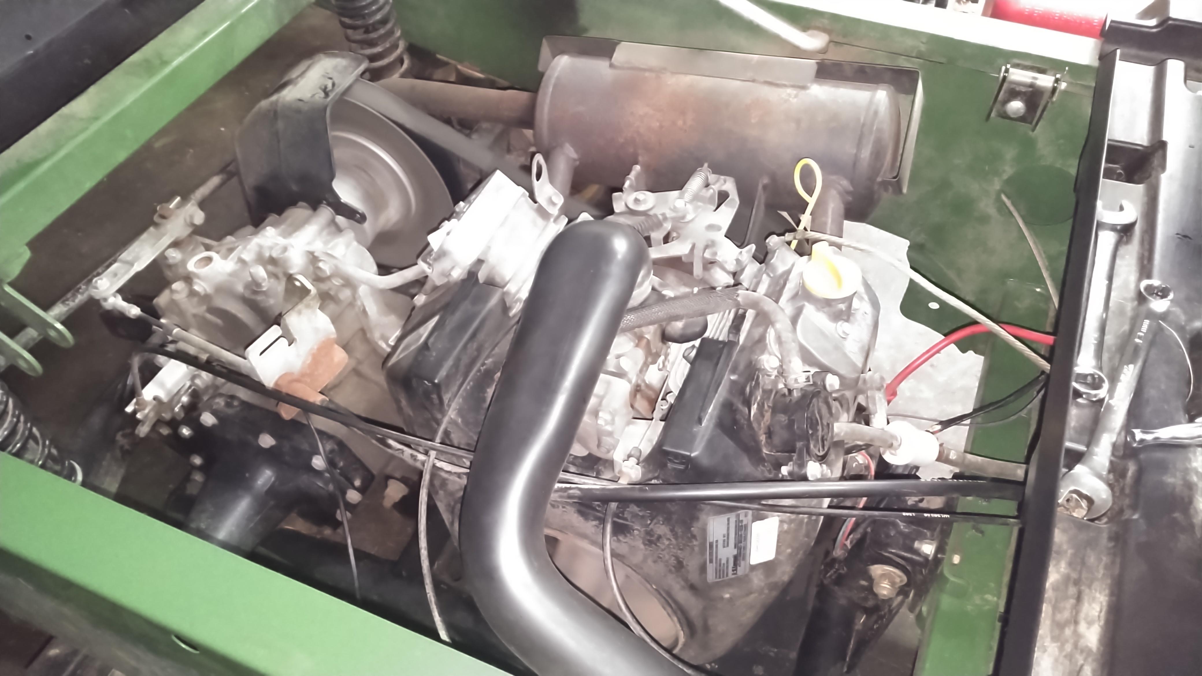

Kawasaki FH601D 19 hp on a Gator. All back together and running. Runs sweet. Tomorrow just need to double check the valve clearances and run her some more to ensure that she is 100% ready to go. Giant shoutout to @Onan18 for his advice on repairing it!!

Did the final checks and test drive on the Gator. Runs excellent and has much more power than before. Guy is coming tomorrow evening to pick up. Glad I was able to get him going for a fraction of what the Deere dealer would have charged him.

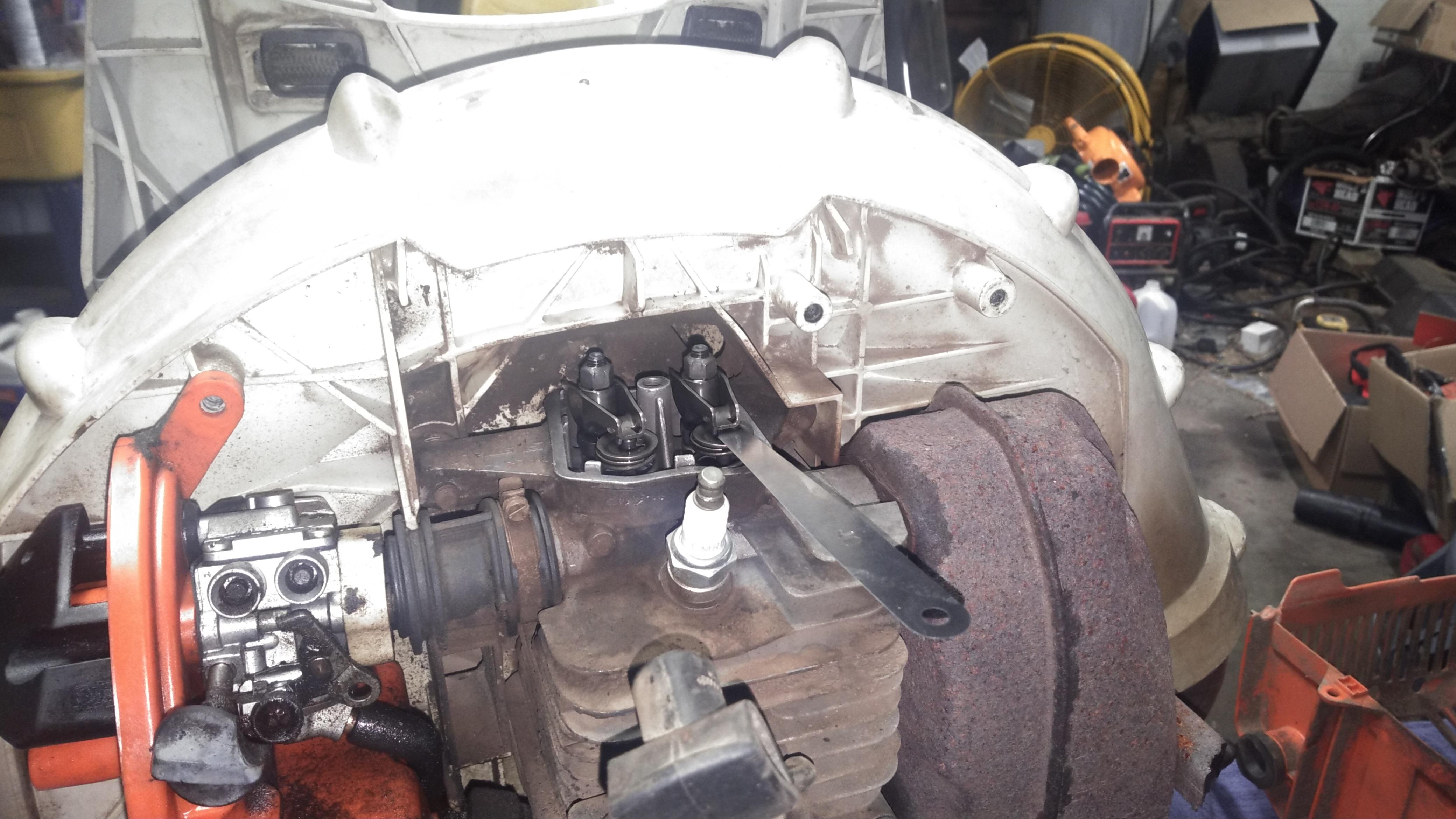

BR600 got a valve adjustment. Compression is much improved as the exhaust valve adjustment was too tight. Still dumping fuel into the cylinder. Pressure tested the carb and it failed. Needs a carb. Let the guy know and he'll get back to me.
