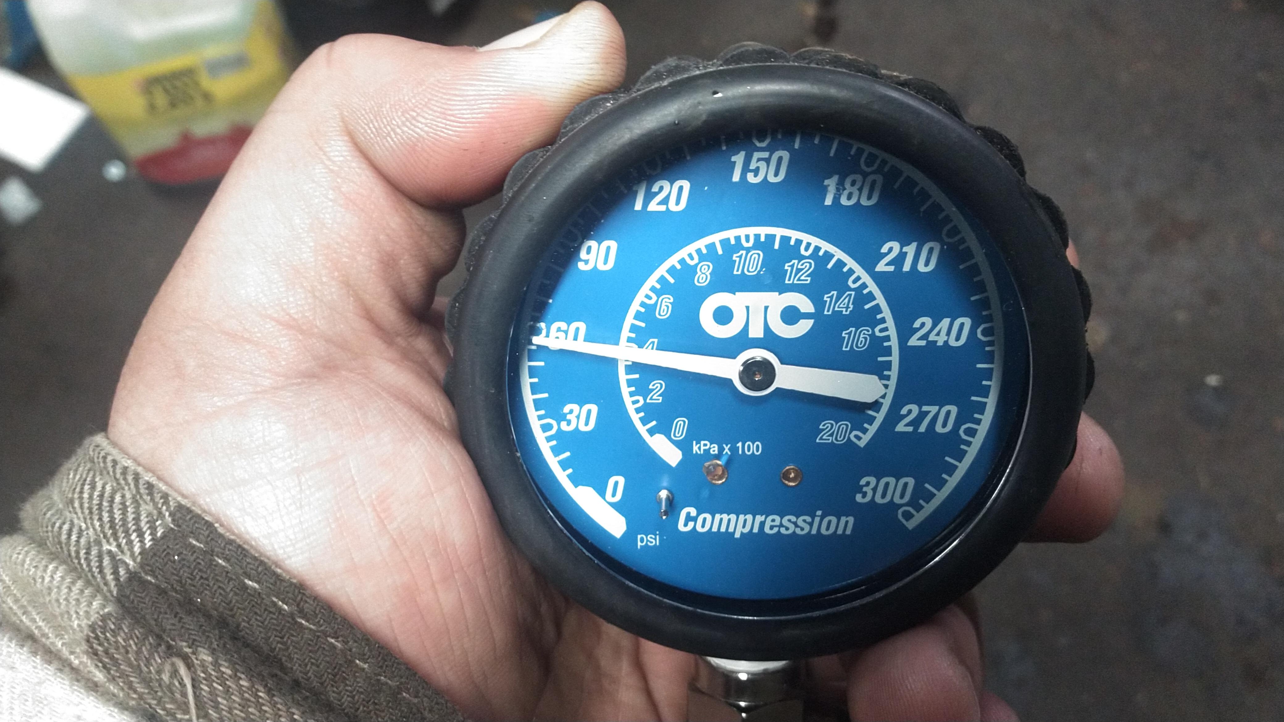

Quickly looked at a br600 last night that wasn't running correctly, compression felt weak when I pulled it over, going to put the gauge on it this evening and if it's low I'll check/adjust the valves and recheck.

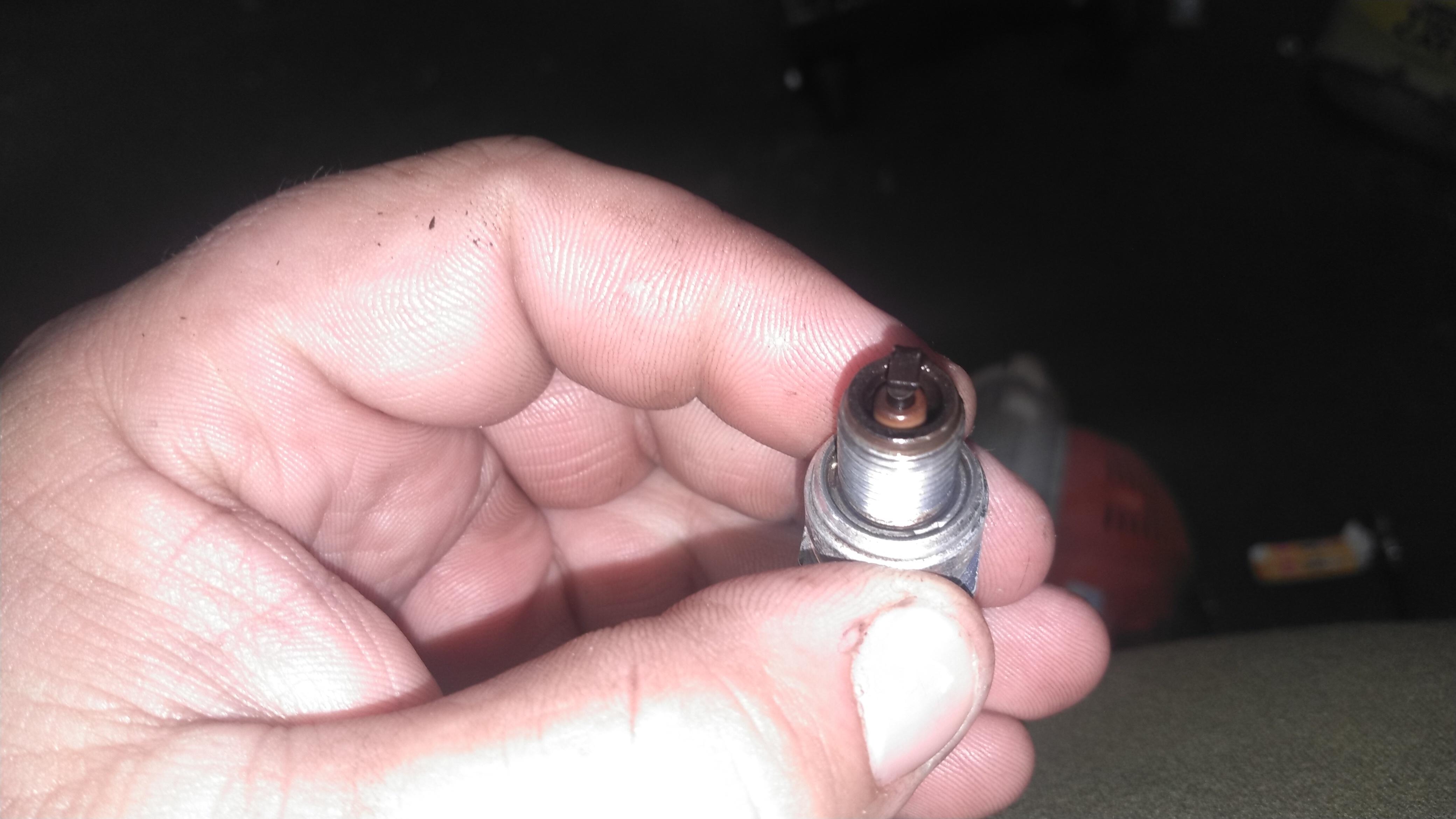

BR600 diagnosis. Compression didn't seem the best but I did learn that they have a compression release. Valve adjustment kit on the way. Plug was wet with fuel. Definitely running very rich. If the valve adjustment helps with the compression I'll recommend a carb along with fuel and air filters and a plug. I will probably do a leakdown test as well.

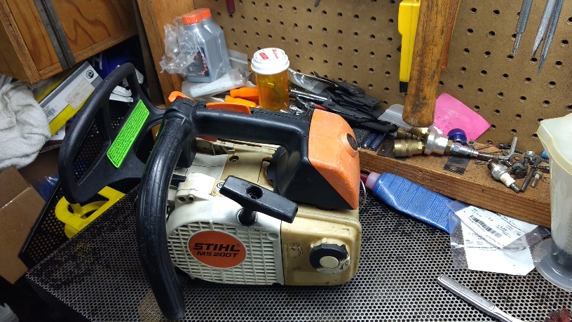

Well (with the impulse attached) it tuned super easy and sounds nice.
Went back inside in the light I could see the fuel line grommet is seeping fuel around the outside.
Swapped it out and took the carb back off.
The throttle trigger felt tough/sticky to me so I went back through the throttle plate/shaft and lubed and "better aligned" it all up. Much smoother now.
This polished turd will get a bar and chain tomorrow and I will have to go find something to cut....
