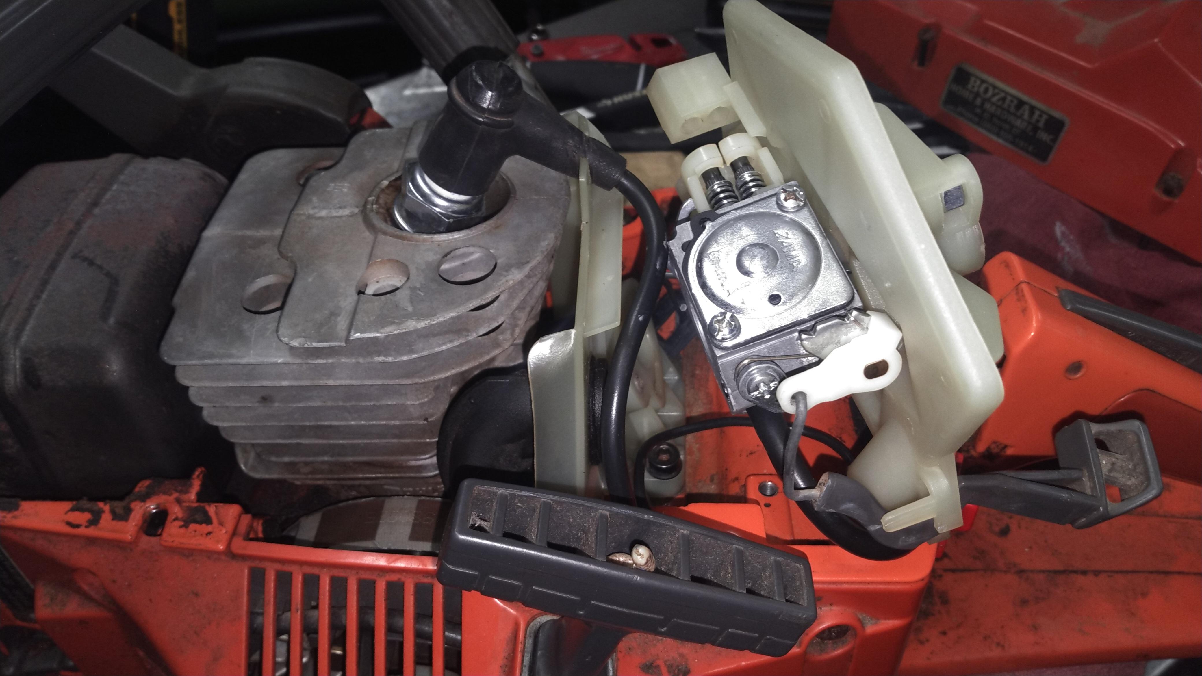

55 Rancher starting reassembly. New intake boot and impulse grommet and carb base reinstalled. It was a bit of a pain in the rear so I stole my girlfriend's hair dryer to warm up the rubber boot a little bit and with a swipe of grease it slipped right together. Reassembling carb tomorrow and if it's setup 3/8 I'm gonna borrow the bar and chain from my 357 to make a few cuts.

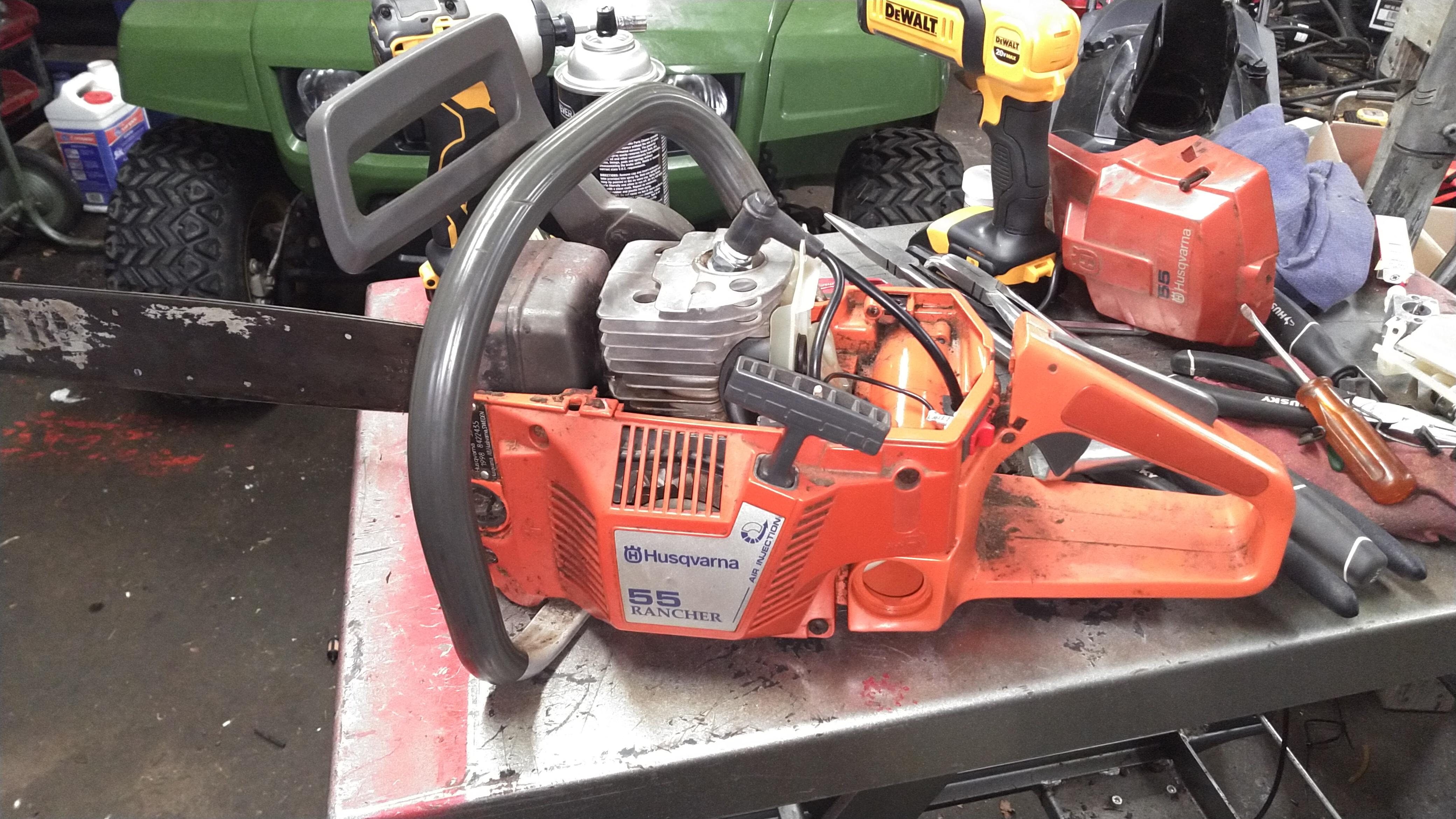

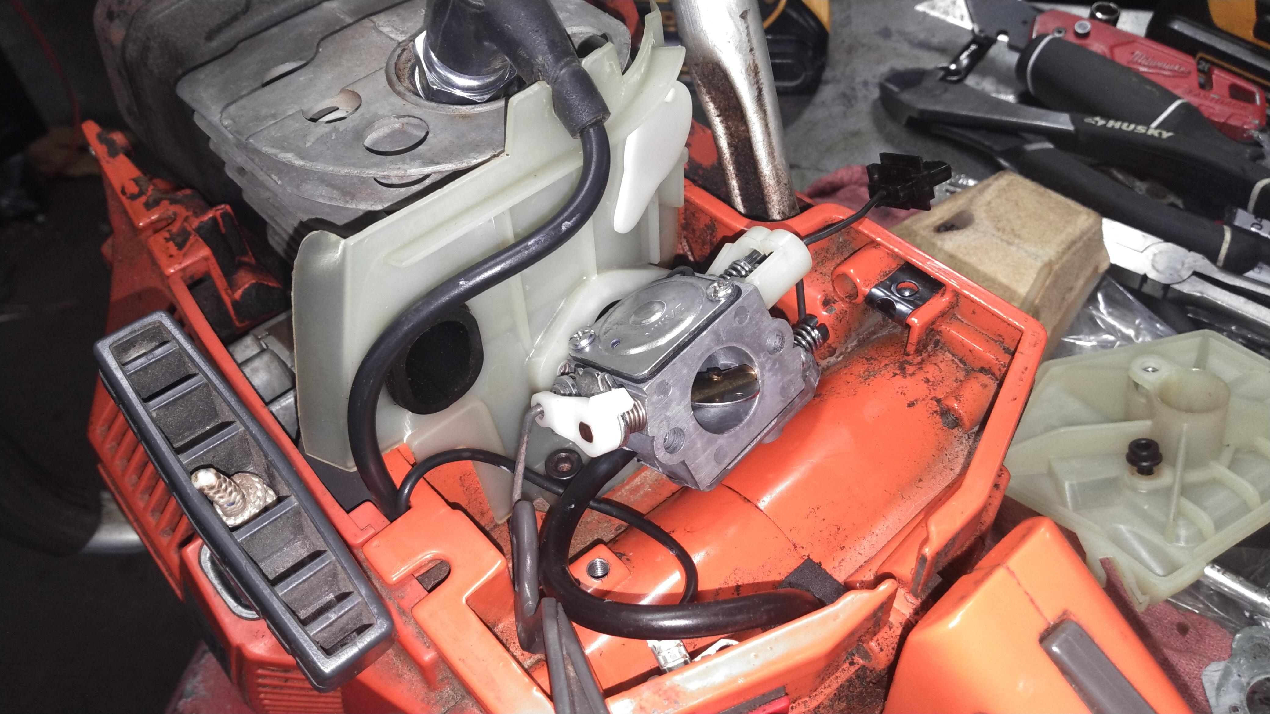

55 Rancher up and running however discovered that it has an air leak between the carb and carb base so I have a new gasket ordered and I'm going to do the @David Young intake upgrade that @malk315 told me about.
What was up with this one. One I have presently is driving me nuts.

Getting running and servicing for a customer. Rebuilt carb, new fuel line, filter and spark plug. Replaced intake boot and impulse grommet while I was in there. Got running this evening and had classic air leak symptoms of too high rpm and not holding a tune. The carb screws go into plastic and the fix is to install 5mm helicoils into the plastic carb base and 5mm socket head cap screws to allow carb to be tightened down properly. That's where my air leak is. @malk315 sent me links to @David Young intake thread for the 51/55 saws. I'll tag you in it.

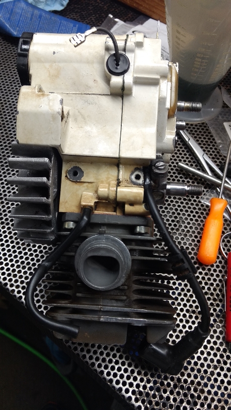

Got back to the 200's for a bit...
The handle I cleaned turned out to be broken so I spent time cleaning another one.
Trying to install it i found the front a/v mounts to be stripped on the case.
Fixed those and finished up assembly except for the carb that still needs the acell pump circuit blocked off.
