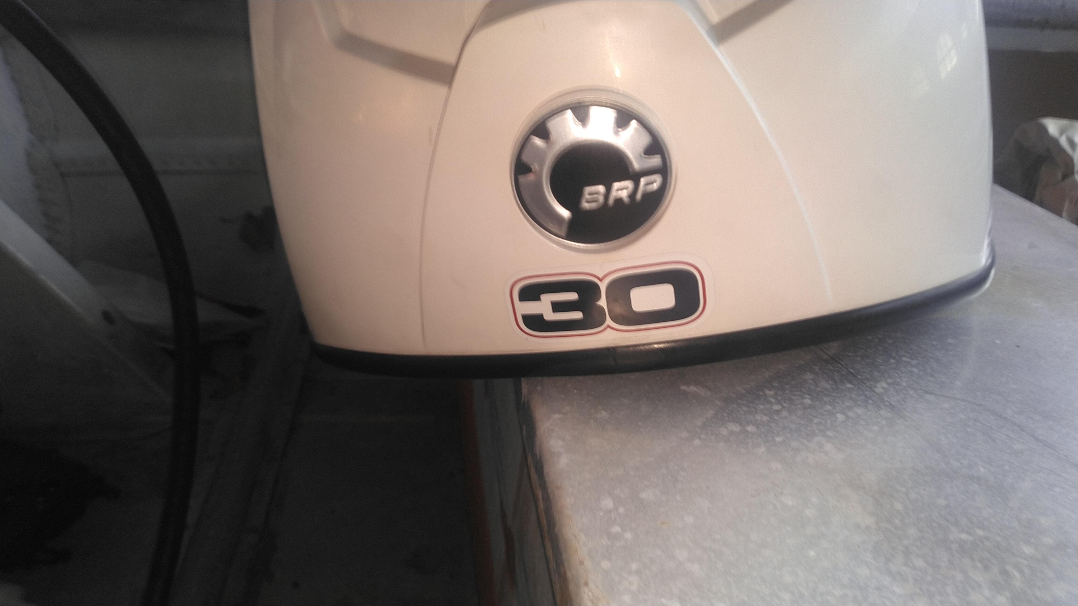

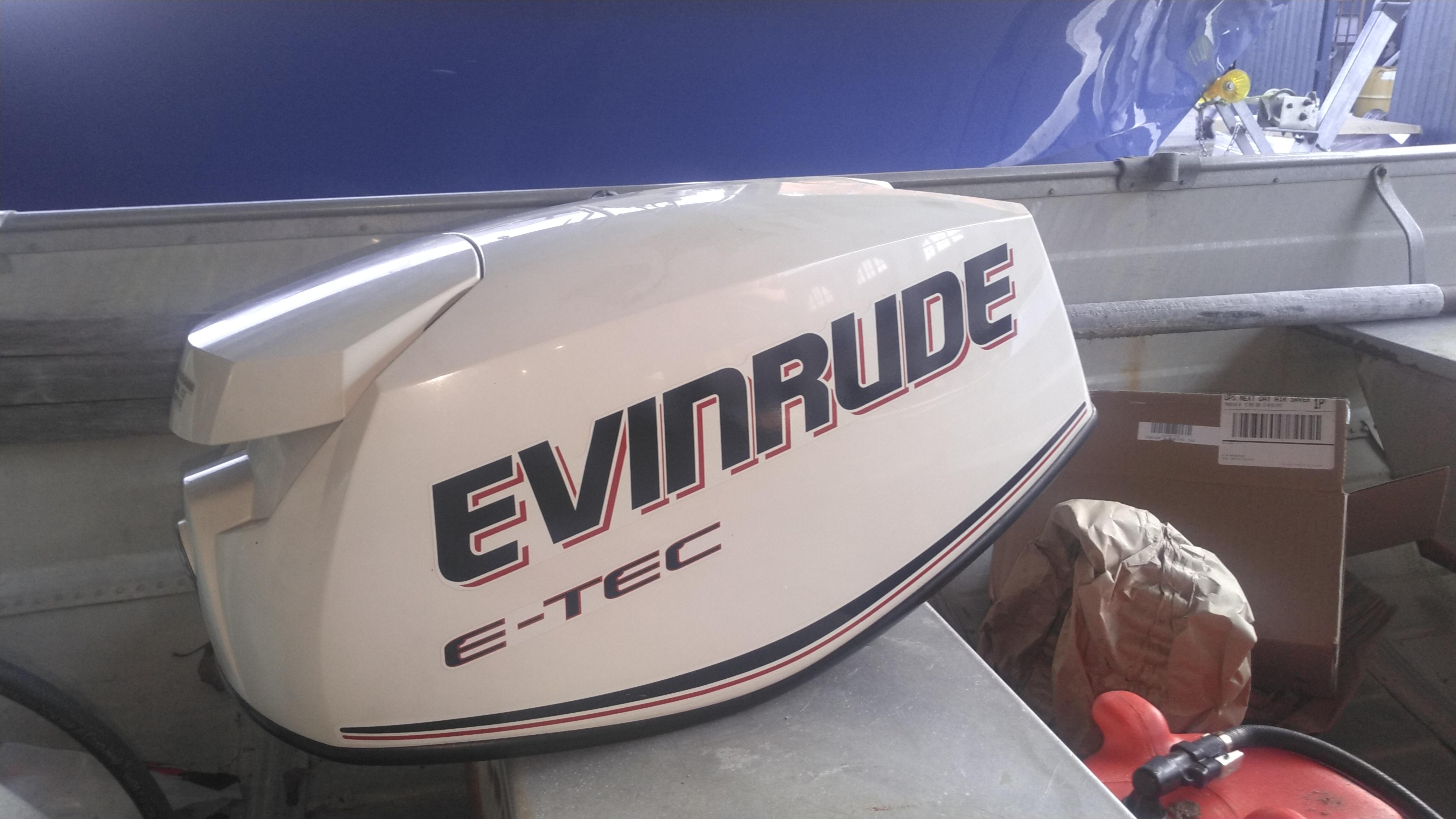

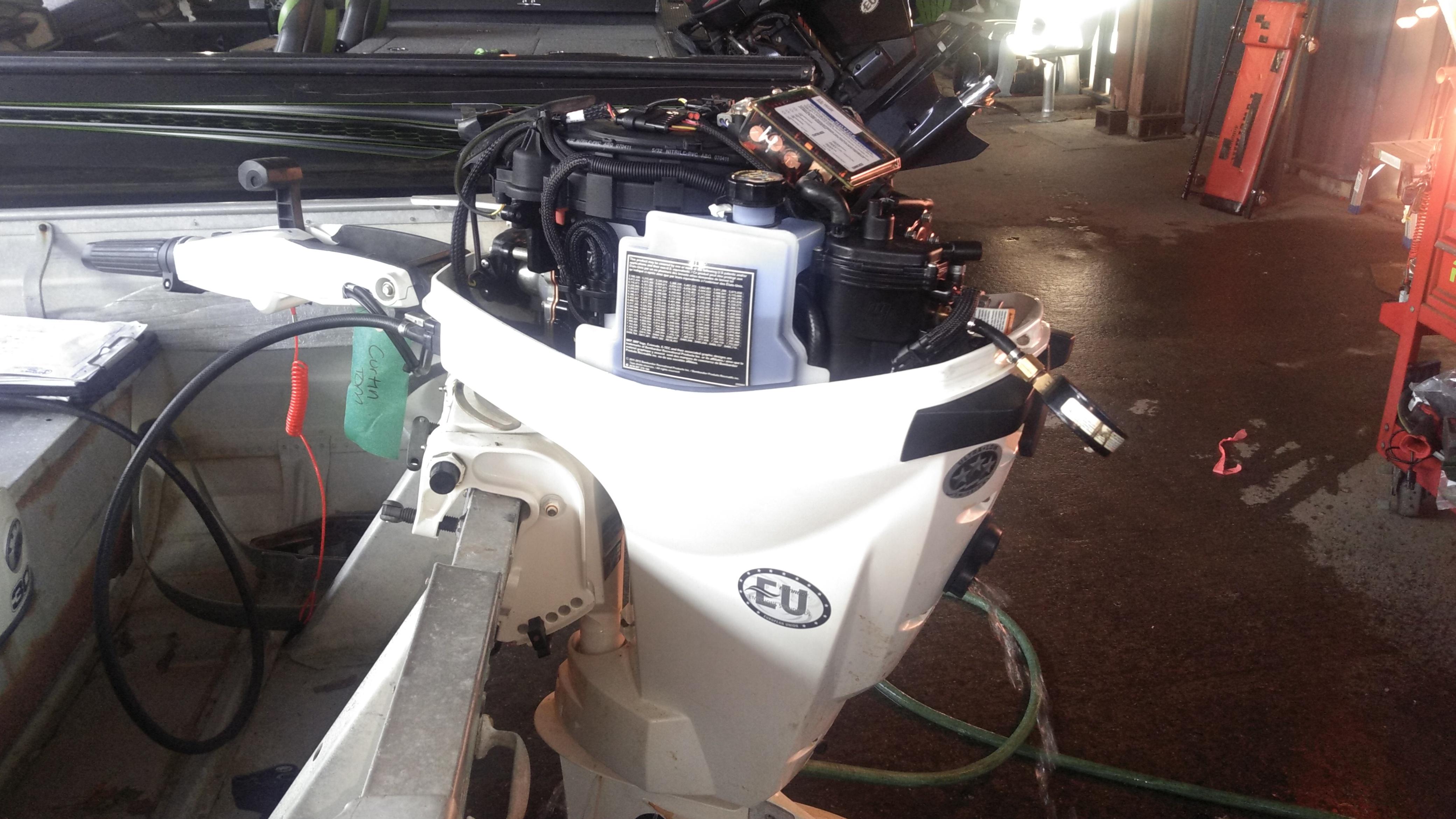

Evinrude ETEC 30 vapor separator/high pressure fuel pump diagnosis and replacement. The pump was intermittently failing electrically and leaving the owner stranded.

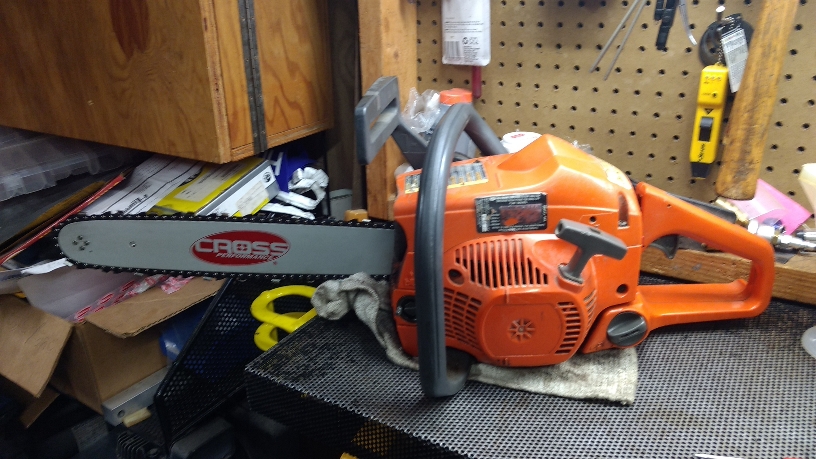

A little turd that needs to go away... Lol
Husqvarna 137
Anyone know that factory setting for the H speed screw?
Runs well at about 2 1/2 or higher but free revs to 14k+
Even turning it out till it about falls out doesn't change it.
Husqvarna 137
[emoji26]
Air leak possibly?

Air leak possibly?
Maybe.
Will idle all day in every orientation...
Won't rev up till H is about 1 1/4 or so then gets better until 2+ then free revs out, doesn't change after that.

Carb took a bath in the USC.
All better now set the H at 2 1/2 free revs to 12800 now.
I think that's about where she should be.
