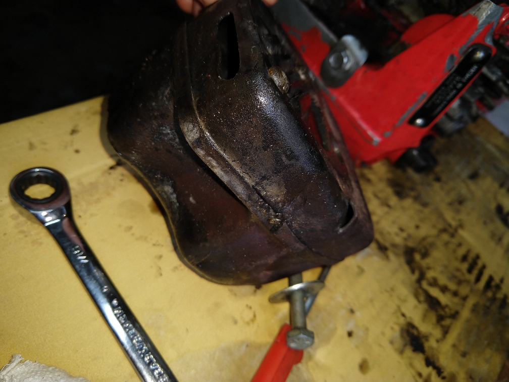

394 wrap WAS really pissin-me-off. Couldn’t get the small scrench behind the wrap & didn’t wanna ruin my most used gift ever. Got tired of fetchin the wobble extension, 12mm, and ratshit........Why not ruin the wrap instead ??AB46506D-5A7F-4576-B855-3AFD8D43275E.jpeg

That scrench is pretty special to me. Twas a gift and came attached with a little Stihl carb adjusting screwdriver. I actually use both ends of the scrench, so ...... the wrap got the sawzall instead.
Tach is goin back on the wrap after welding. Here she’s getting ready to get cut for wrap modsB27A1CC0-F774-4E8B-B893-CA9C1DD3A484.jpeg

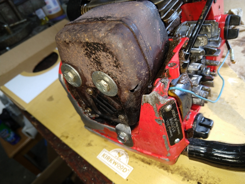

Well, I took the two Homelite XLs apart and they were altogether different from each other. They looked to have the same engine and ignition coil but the carbs were different and the fuel and oil lines were different also. I'm gonna take the simplest carb and try to use the engine it came on and modify the lines to the easiest routing I can do. I tried taking pics but since my computer upgraded I'm having trouble uploading the pics to the computer. Maybe I'll figure it out..I have a bunch more of the Homelites to try to get running, two 330s, a 360, and another Super 2. I did a plastic Super 2 earlier this year and a metal one that still needs a carburetor.

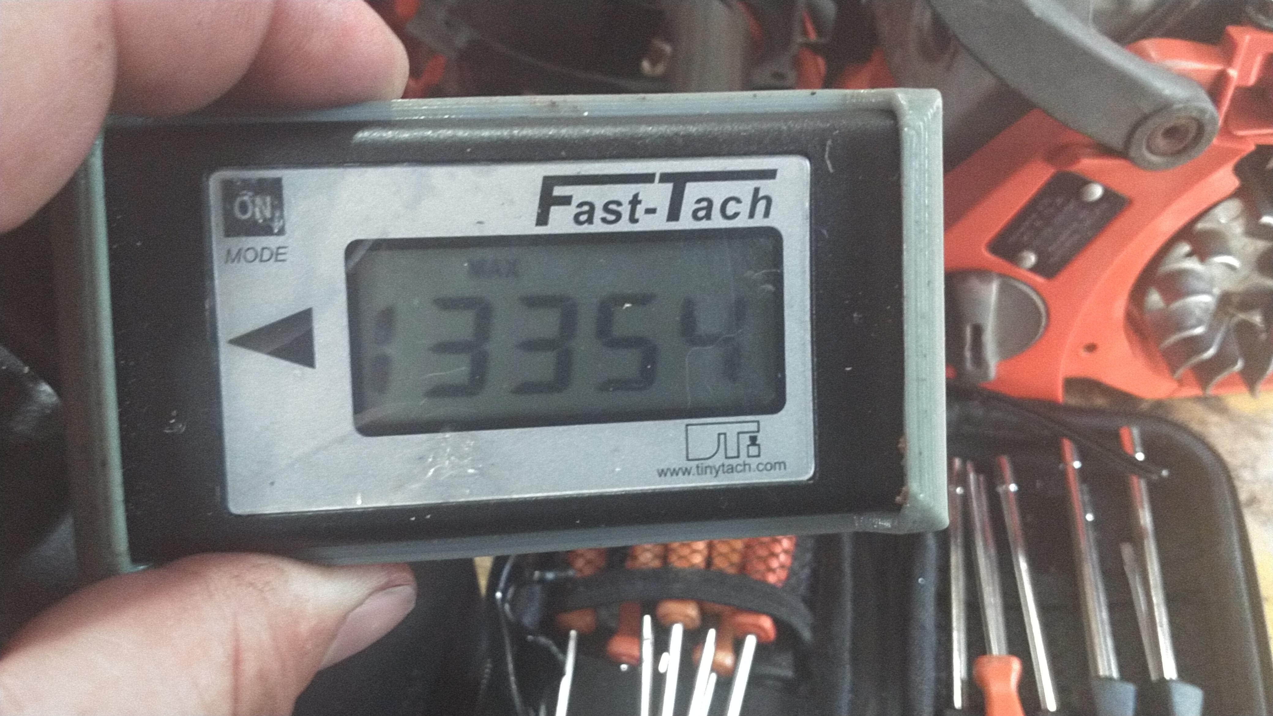

355t is fully tuned it was maybe 1/2 turn-out/CCW for L, and 3/4 for H (CCW), for 'optimal' of my new / 2nd-tank 355t running on ~45:1 by this point (started 40:1 motomix, keep adding neat 50:1 moto or echo mix so it'll "transition" to a 50:1 over some tankfuls, the tankfuls I'll be 'babying it' / keeping the tach 'semi-permanently' attached to....started-out as a tuning thing but I like that it keeps total-hours-logged on it, kinda neat to have an hours-counter for my fave [by leaps&bounds] saw!!

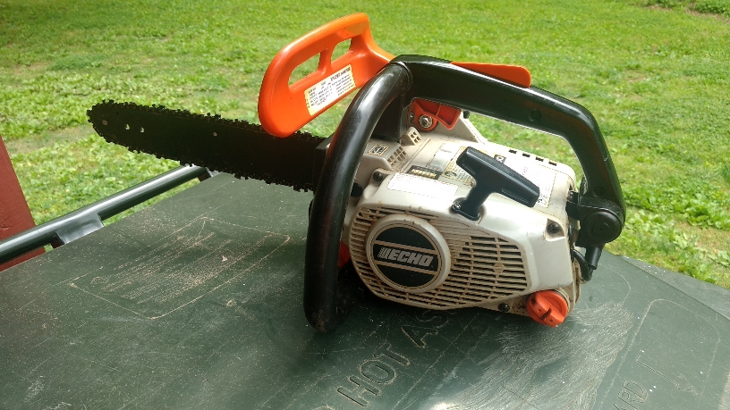

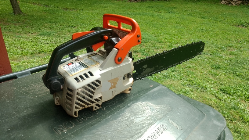

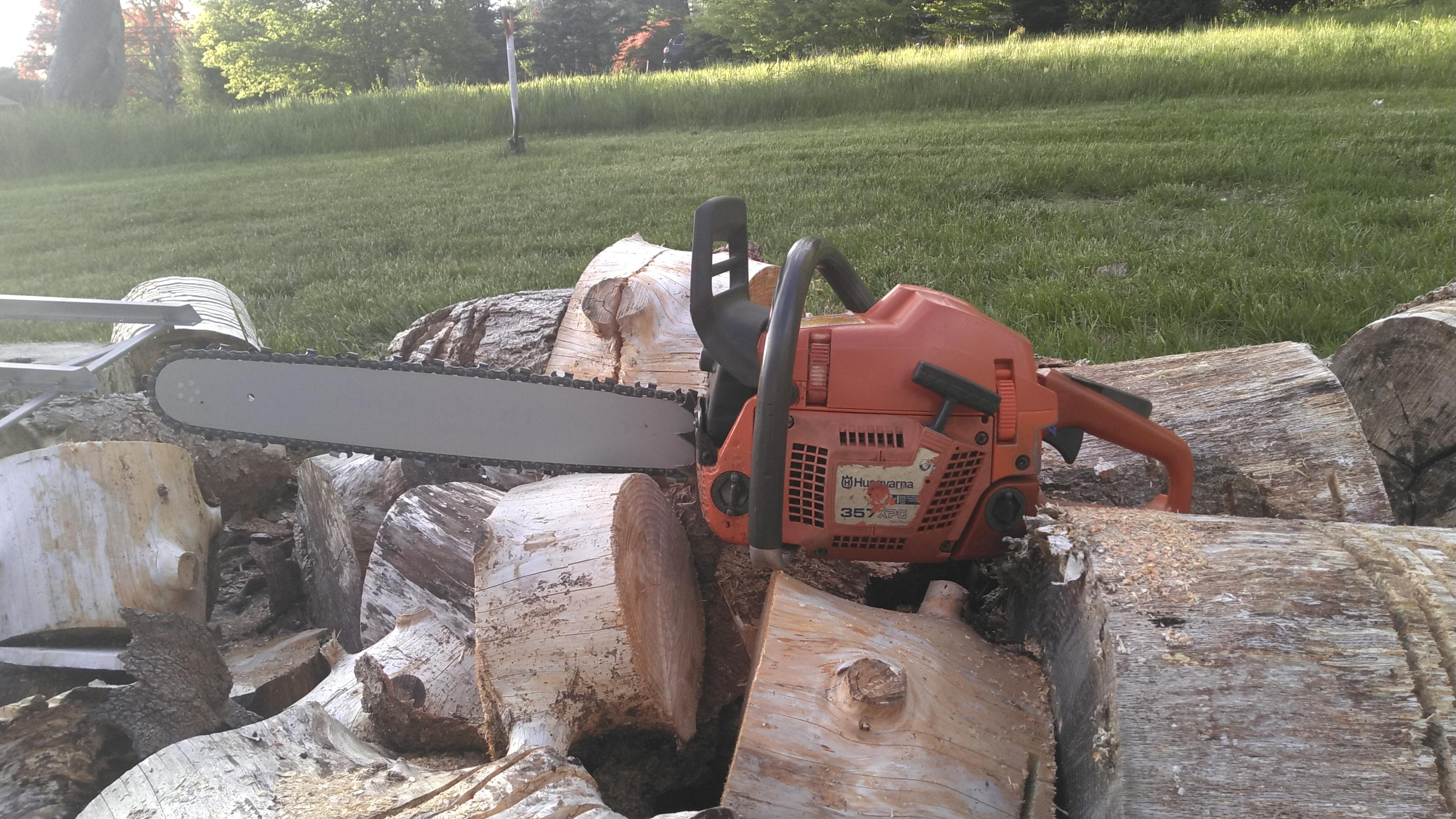

Borrowed a bar from @paragonbuilder , tossed it and a loop of EXL chain on her, did some carb tweaking, made a few cuts and she pulls nicely! Still fat for breakin. Test cut video tomorrow! Idles nice when hot, restarts 1 pull hot, I think I did okay!

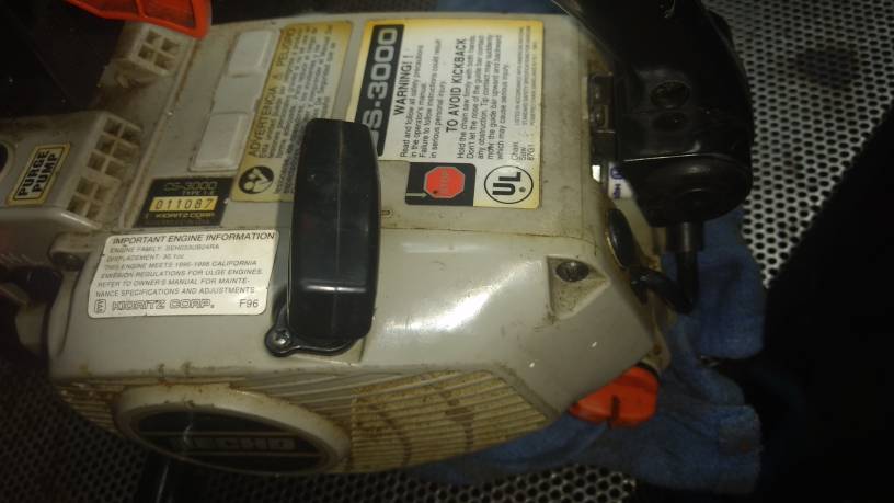

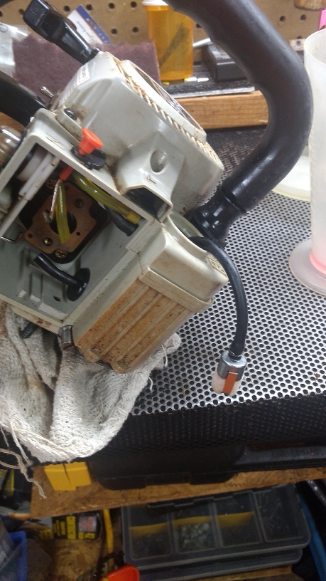

Real easy saw to work on.
Pulled muffler and cleaned, it was full of carbon and sludge but not plugged.
Pulled carb and went though, everything seemed fine.
Primer bulb lines were hooked up backwards.
Took a bit of time to get it to tune.
It wanted to be quite rich on the low to rev smoothly.

I have 2 of those. Not too bad to deal with. And they are a little of a pain to tune.

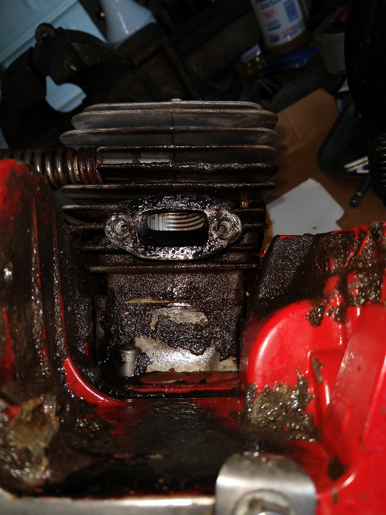

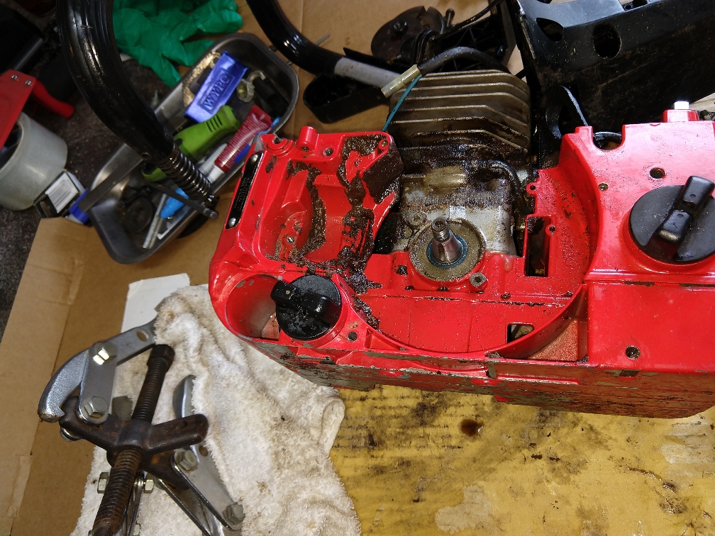

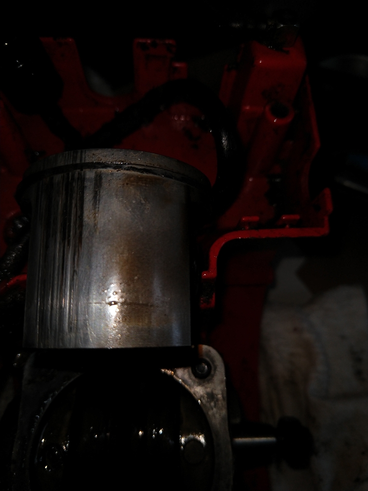

Working on a local fellas 192t. Intake boot split and things went downhill from there. He said it started acting funny but kept on running it. Amazing how many people will just keep running a saw when a problem arises instead of stopping and figuring out the problem. Now instead of just a boot, hes in for a new oem top end, boot and new seals while it's all apart anyways. IMG_20200517_123940.jpg IMG_20200517_122735.jpg
