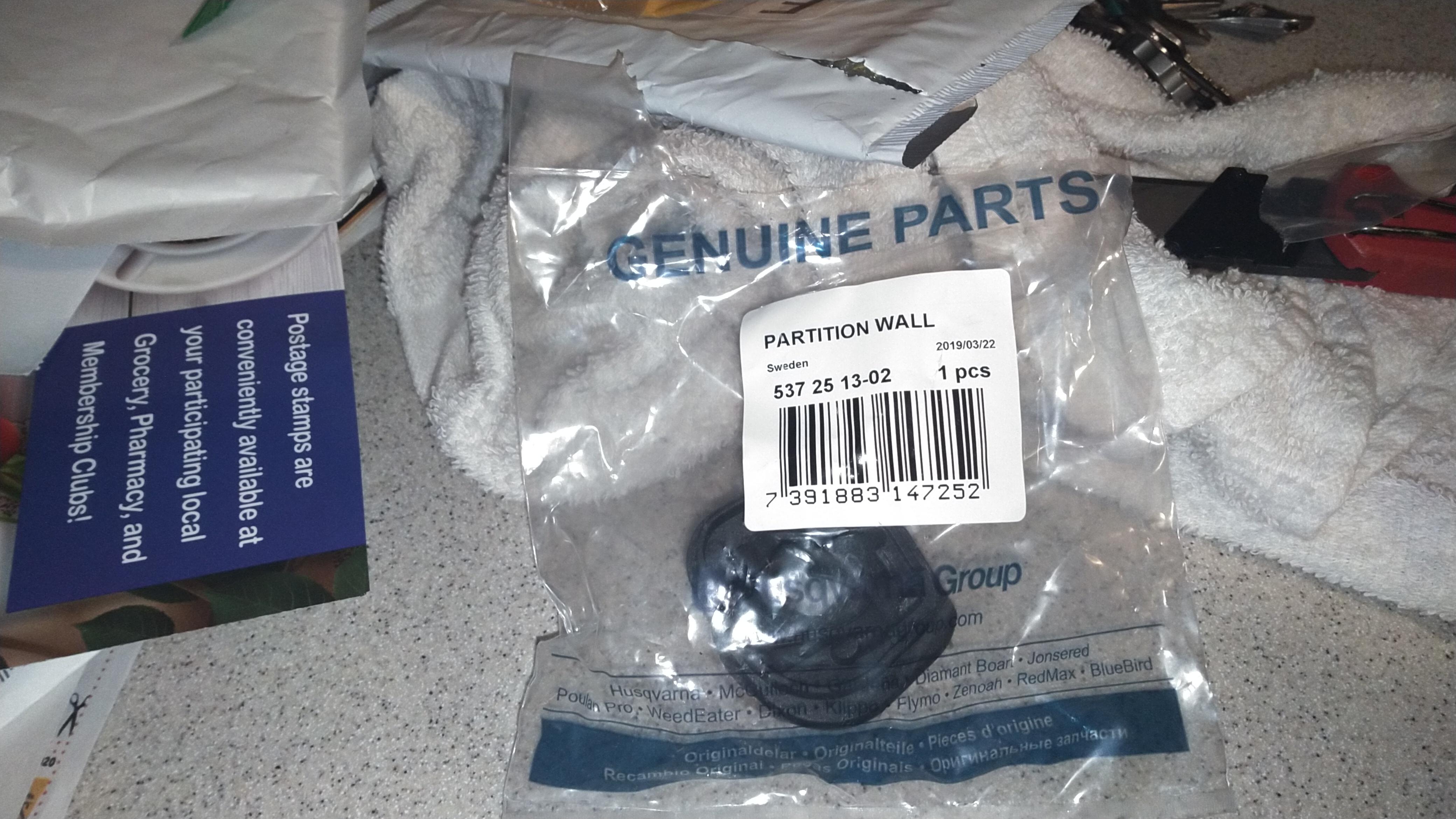

Replaced the intake boot, partition wall and clamp on my 346xp conversion. Air leak repaired!
